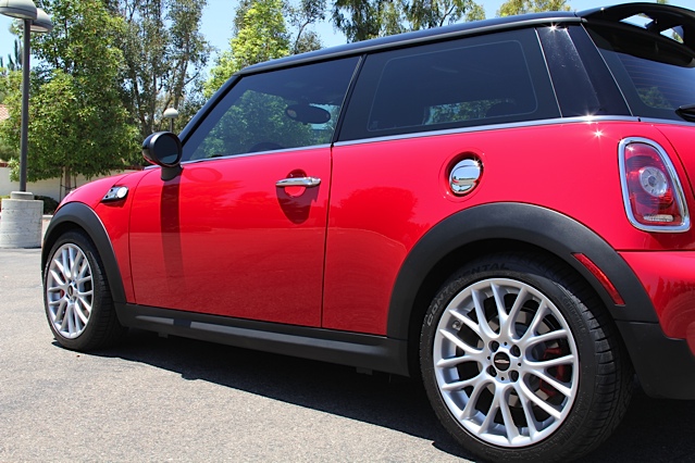

Thumbs up for Mike at Tech Division! He did a fantastic job on my TSW spring installation, and cost was very reasonable.

How does it look? After seeing a few threads about weird stance with TSW's, I'm curious. Please post pictures if you can

JCW with TSW Springs
Hope these photos help!

good pics, I wanna get some TSWs so that was good to see the gap
