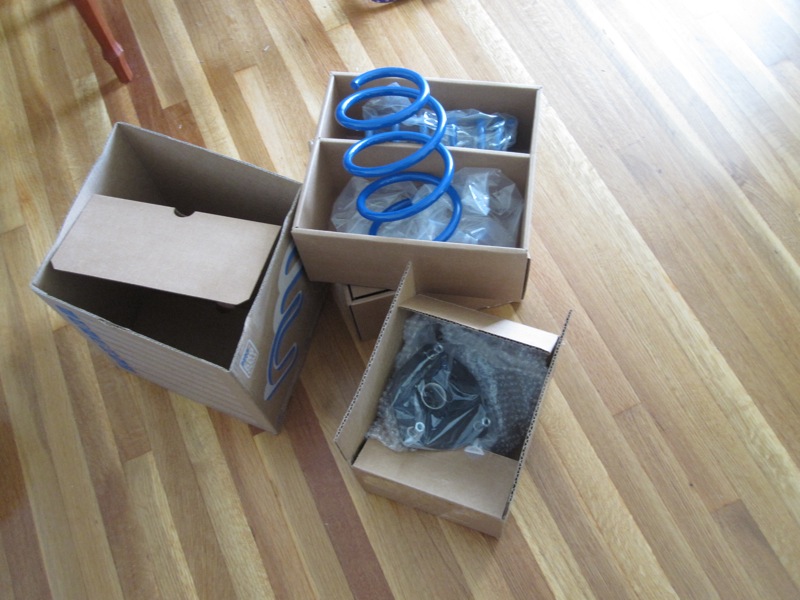

i have received the NM spring and the IE fixed camber plates, still waiting for the KONI to arrive, so i can begin my upgrade!! cant wait!!

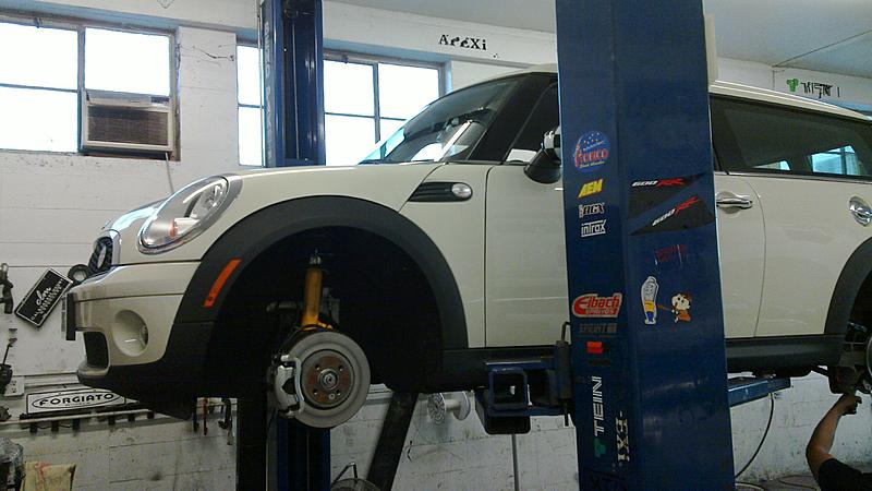

hey guys! i didnt have time to do the upgrade myself, so i sent my clubman to a local shop to do the job for me. ($150 labor, sounds lazy to me )
should pick it up before 6pm today! so exciting!
Old Feb 9, 2011 | 08:31 PM
3leafz's Avatar
3leafz
Joined: Jul 2010
Posts: 133
took a pix while waiting at the shop... but didnt have a chance to take the on-wheel pix because it was already dawn when i pick up my clubman....
these koni shocks are amazing! i can feel the ride is much firmer than the stock suspension even i have the dampening setting at the full softest position!
will get alignment done within 100 miles as i dont want to wear too much of my new tyres
maybe i should put back the 15" wheels before alignment?
