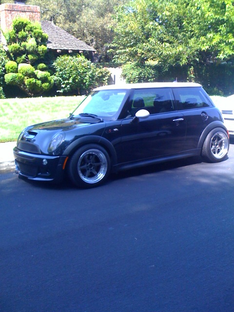

hey everyone ...
i got some new mods .. new set of Megan coilovers with lower front springs . and lower control arms . tsxwerks stud conversion.... all bought from dustin from autoxcooper.com he is an awesome person to buy from.. awesome deals and great customer service.. i will buy more stuff from him ..
specs:
XXR 513 16x8 15et
toyo proxes 195/50/16
Megan coilovers w/ lower front springs
lower control arms
-2.5 neg camber all around .
trimmed front ffenders and lower front bumper .

looks good. just make sure you dont run over big pot holes. those wheels
are infamous to shatter (not bend).

yeh.. i heard some bad stories.. but my dad has another set of xxr on his NA miata for about a year and drives it everyday and nothing negative about them sofar... but of course i gotta pay attention with those potholes.. especially here in SF bay area roads...

Good to see another MINI owner with a focus with a nice poke/stretch stance. Glad those wheels finally worked out for you Looks good
What tires did you choose? Doesn't look like they stretched very well. May want to try falkens or toyos next time around for some more clearance and less of a balloon look.

Not trying to be cold, and certainly hope it doesn't come off that way.
I think it looks great the way it is.....just offered up an alternative since rubbing may be an issue.
Like I said.....car looks killer
If you need some clearance, certain tires have different profile stretch shapes some "flare" as they stretch and some "balloon". It wasn't meant as a burn....it's just a word to describe stretch shapes

Definitely looks awesome, but you now have less tread than stock on an already traction handicapped front wheel drive car...

Do you have issues with traction in your everyday drive around town? Accelerating from stop lights up to maybe 45mph?
I think that 195, although skinny, would be plenty of tire for the traction requirements found in daily driving. It's a 10mm difference in section width...hardly a big change from the average 205 that most people run, and still larger than the 165 and 175 that MC owners run.

rally: the tires are toyo proxes .. but arent t1-r or t1s .. i bought these from a fam relative so they came with tires.. i will change new tires once these are worn out.. and get something that stretches more....

Not sure why I'm just now seeing this, but Thank You for the order of parts and the positive feedback. I enjoy seeing my customers MINI's after mods. On camber settings. You may want to dial it back in the front to -1.25 for daily to safe tire wear and the rear near stock if the rear is set at -2.5 I think you will blow though tires. I know there are other threads dealing with this issue, I encourage to research them and adjust as needed.

The -2.5 helps tuck the et15 wheels.....I ran the same specs up front between camber, offsets, and widths. A -1.25 wouldn't allow you to lower as much as he has with the wheels hes got.
-2.5 up front feels great too

yeh thats true.. and i had to trim the front fender... but i dont rub at all up front.. i have a slight rub in the rear when i hit big dips... roads here in San francisco is terrible. i need to shave the rear fender
