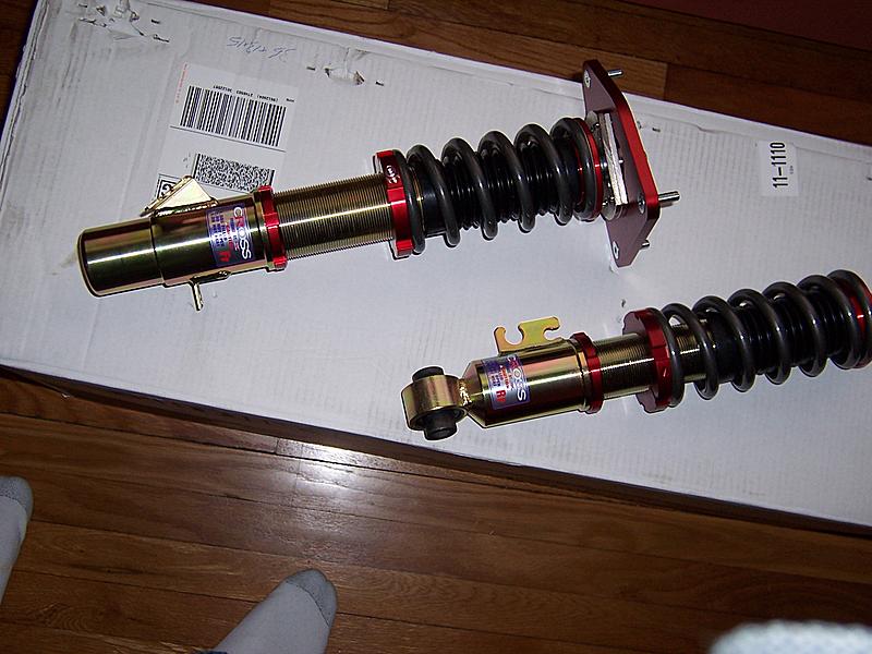

Do these coilovers come with camber adjustment or you gotta buy something seperate?
Old Apr 16, 2008 | 02:17 PM
  #40
jpavlo's Avatar
jpavlo
Joined: Nov 2002
Posts: 103
From: Endicott, NY
Yes, they come w/ camber plates
JIC/Cross Coilovers installed!-cross-coilover-1.jpg
Attachment 31304
Thanks! guess I need to call Jan!
