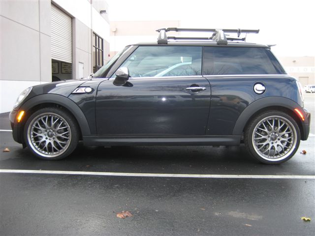

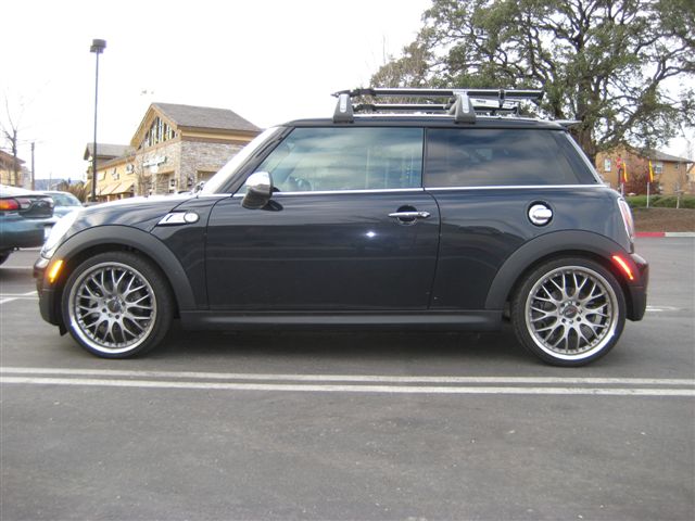

Attachment 39182Thanks for the feedback. I had the springs installed today. Very early still but so far I will say that some of the things I've read here are true, that it does actually seem to ride better than the stock springs and torque steer seems greatly reduced!
However, the ride height is almost identical to stock! So much so (only about 3/8" front and rear), that after putting in the springs the installer took it upon himself to call txwerks and ask them what was up. He was told that they would settle to the tune of about 1" front and 3/4" rear just like they've said on this site many times.
I sure hope that happens! I did only want a subtle drop but paid decent $$ for the parts and installation and want to be able to notice it!

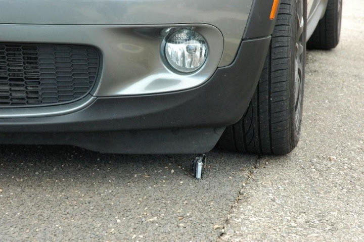

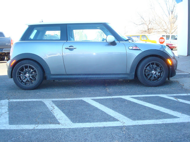

Warmed up in Colorado, so I took the MINI out for a picture or two.
This is the front and side view of my MCSa with the TSW R56 springs after 500 miles. I really do like the ride.
I currently have my Hotchkiss 19mm set in the middle setting, flat and firm ride, much better than stock.
My Ziex 912s 205/50/16 are about at the end useful life, they have become noisy but have some good usage left as my M&S. I will switch to my 205/50/16 Eagle F1 GS-D3s in a few weeks on these wheels.
That is a motorola k1zr below the damn, about a finger width of gap between phone a damn.
Side view with 205/50/16s. My winter tires, but I have put them on the track.
My 17s will fill in the gap a bit more, nice subtle drop and great ride.

Is the rear lower than the front, or is it just me?

Are you talking gap visual? I really must measure the lower rim to arch and see what it tells me.
Look at the public album in my picasa area for some other views.
Yeah it looks a bit lower in the back. Maybe the front needs a little more settling time.

torque steer is minimal, better I would say.
I still have not measured the front and rear height, but the rear looks higher in real life. I like the stance as it has settled.
Perhaps a 200 more miles and I will take pictures again. We are getting a little snow today.

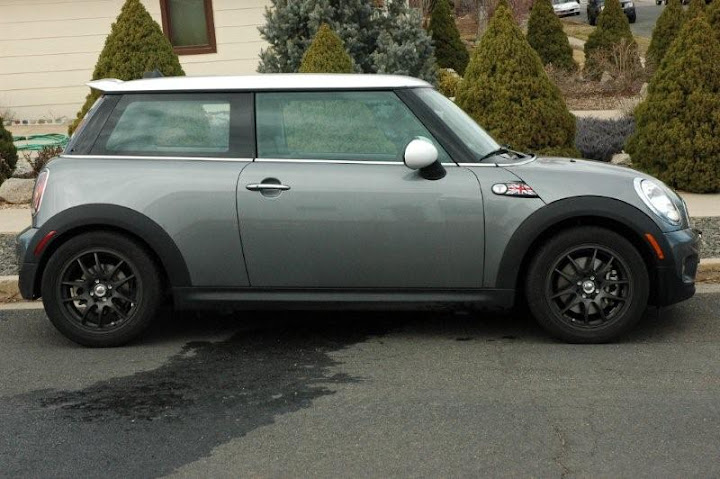

Ok, for those curious, I took another picture today after the 250 mile run up the Front Range and through our great mountain roads.
I measured under the side trim just before and after the f/r jack points.
Currently sitting at 7 inches in back and 5 3/4 inches in the front. Total miles on the springs near 800. No issues, I like in the mountain twisties.
Somebody go measure your 07/08/09 MCS sitting on stock springs. I would like to know what stock is supposed to be without running down to the dealer, 45 miles away.

^^Looking good man! I'm getting excited about putting these on in March!
