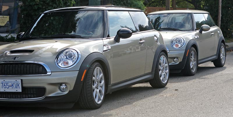

Many have commented here, and it's been my experience, that the 1.25" drop with Mach V springs on R56:
greatly reduces or eliminates torque steer
makes corners even more fun
slightly rougher ride (some argue this)
looks much better (no argues with this!)
btw: my R56 came with sport suspension and LSD
Here's a photo of two 07 sparkling silver. Mine, the front car, is lowered.

Thanks for the photo, I have been looking for a lowered car with flame spokes.
Old Feb 14, 2008 | 12:21 PM
ACooperS's Avatar
ACooperS
Joined: Aug 2007
Posts: 153
Closer look at the flame spokes/Mach V/stock run flats:
http://johncameron.ca/mini/large-37.html
http://johncameron.ca/mini/large-38.html
