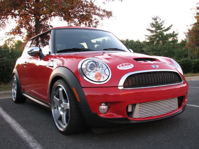

fmic ftw

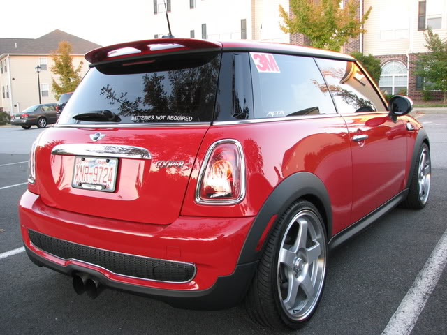

this is jcw suspension with mach v springs and goodyear f1 all season....the ride it pretty rough on big city streets, but very sporty...not for the faint of heart
Old Nov 30, 2007 | 04:44 AM
  #75
ACooperS's Avatar
ACooperS
Joined: Aug 2007
Posts: 153
That's one nice looking MINI. Ride height is perfect. Can't argue with the colour either.
