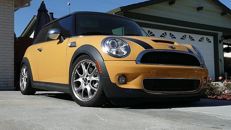

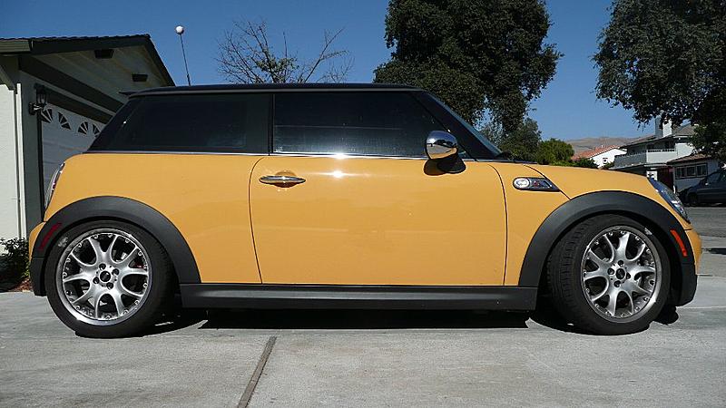

just installed my H&R coilovers
hey guys i just installed my H&R coilovers, i had some slight problems but thanks to adam from alta i had it all figured out. the pictures are on the lowest setting on both the front and rear.
i notice that the suspension doesnt handle that well on the onramps over SS. but it does handle better lower speed corners like around 30-40mph.
the lowest setting is too low for my preferance i think. it will probably handle better once i rise the back end a bit. i like how the front is. current there is a gap between the front tires and the fender while the rear is tucked in. i want to get the rear to have a bigger gap than the fronts.
also i hear some noise from the front when i make slight turns. sounds like viabrations
the endlinks are pencil thick.. i think i have to replace those
any suggestions

so i just read another fourm about the height of the car and something about for best handling, probably not any lower than an inch from stock height. would you guys think this is true? i was planning to rise the rear up to have an inch gap. is that enough?

It looks sweet though!! I love the tucked look. I probably would raise it just a bit! But once again it looks SCHWEET!

I'd raise it to make it the equivalent to having it lowered about 1" from stock ride height.

Nice work. Car looks hot slammed....but like you said, I'm sure the handling is suffering a little.
Lowering that much really alters the geometry of the suspension...I was basically just going to reiterate what a96bimmer said.

Your car is still pretty high up off the ground for that being the lowest setting. What size wheels are those? 17"?

yeh they are 17 inch rims and im on stock ss sway bar. okay ill rise the car up and check the lower control arm for the angle. im planning to change the endlinks first thing and maybe the control arms.
