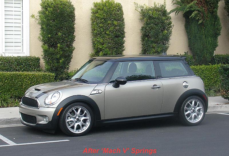

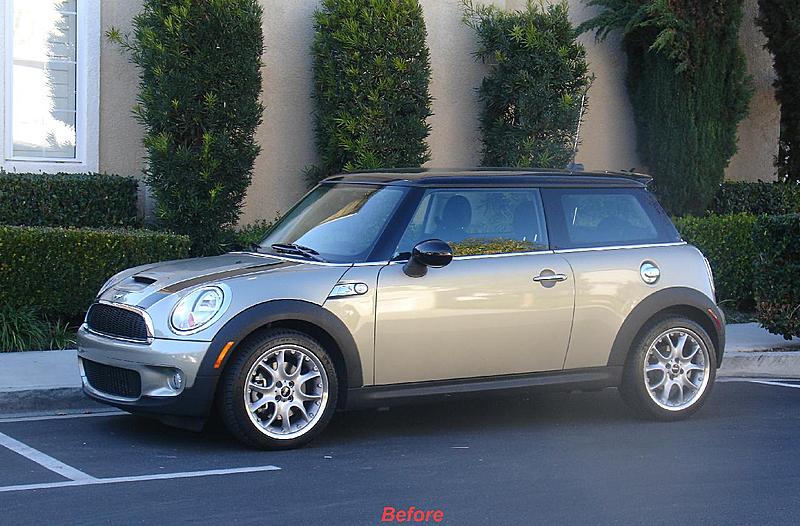

Old Feb 13, 2008 | 11:10 PM
  #163
Hoopty's Avatar
Hoopty
Joined: Dec 2007
Posts: 133
From: Mission Viejo, CA
See my gallery for before and after pictures......
I installed my Mach V springs the other night.....and I'm super pleased with the results. Its funny how the lines of the car change when lowered. The whole body looks thinner and the roof line looks lower....like I chopped the top a couple inches.
Attached Thumbnails No more teasing: Mach V Technic Springs now shipping.-mini-lowered-a.jpg   No more teasing: Mach V Technic Springs now shipping.-mini-stock-a.jpg

Old Feb 14, 2008 | 05:18 AM
  #164
CUTiger3's Avatar
CUTiger3
Joined: Sep 2002
Posts: 296
From: Upstate South Carolina
That looks Great
