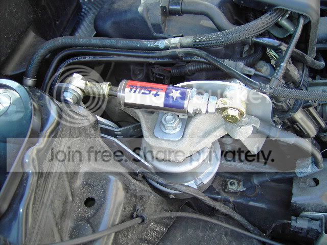

Either of the remote mount engine dampers available through this site (TSW or LOTF) should take some of the stress off of the stock damper. And they both improve shifting, as well.
Zip
