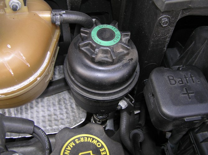

here is a pic of the reservoir that moves when that noise happens...
Is this the power steering fluid container?

i think that is the one. is the power steering fan supposed to spin when the car is on because mine does not. it feels like it is catching on something when i try to spin it with my hand. i have a feeling its about to go. mine is an 02
