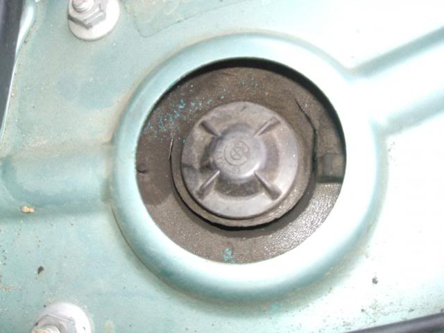

R50's mushroom!
So here's what we have in the driveway:
'02 R50, 3/2002 build, BRG:
Cracked mount (correct?) on the passenger side, mushrooming on both
'03 R50, Silk Green:
Cracked mount on drivers side, mushrooming on both
So what's my best option here? The IE fixed camber plates look beefy but will not fit the BRG model due to the build date. Should I get an OEM pair of the cracked things and replace one on each car? And what exactly are these called?
As far as the mushrooming I was thinking of getting both the Strut Tower Defenders and Under Tower Indurators from CravenSpeed. And then of course an alignment.
Anybody else have both of the CravenSpeed products installed?
Val

You ppl need new upper strut mounts, 12 years on a strut mount ..the mushrooming is a weak point but mounts are not built to be lifelong! this is a maintenance item! how long have you rode on blown struts? blown mounts? both?
Val- have the mounts replaced, struts and ride height checked to verify they are ok, align and drive.
simplj- you have another issue going on.

yeah, i think my issue was being a cheap a$$ and going with aftermarket replacements rather than OEM.
