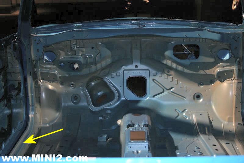

It's tough to tell for sure in this photo (from a MINI Oxford exhibit of the '07), but it looks like the problematic pinch weld is less crude on the new body.
But the real test is what is done in actual production. The car has to be griped as it moves along the production line some how. And then, there is the question of the weather seals.... Only time will tell if MINI learned from the first iteration....
