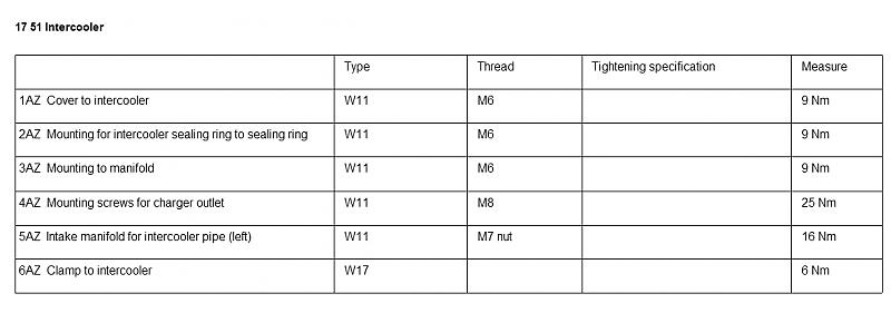

I've read about the upcoming 05 supplement due out in Mar. perhaps. I will wait....in the mean time, can you tell me what the torque specs are for the plastic IC cover-mounted to the top of the intercooler? and the torque specs for the four (4) IC boot clamps bolts. I believe these are #30 torq. bolts. It's time to get rid of the oil build up.....Thanks for your time.

The BMW TIS CD-ROM has this table for intercooler torque values.

FANTASTIC! This is exactly what I have been looking/hoping for-real numbers. Not just, "Oh, just a little past hand-tight otta' do'er". Thanks for digging this information out and passing it along. MOTORRR
