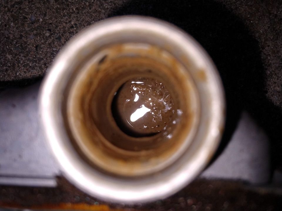

I *think* I've narrowed down my lack-of-heat problem to the heater core, but just wanted to see if anyone had any other suggestions of things to check:
-Barely getting lukewarm air on the driver side, passenger side is cold.
-New coolant hoses (one of mine was old and cracked), thermostat, and coolant a couple years ago at the shop.
-Bled from both bleed screws more times than I can count (car warmed up, temp on high, low fan, high fan, on flat ground, again with the front raised, tried it all)
-Temp gauge stays right in the middle and engine fan seems to come on and off normally.
-Replaced cabin air filter (needed it anyway, but didn't change any HVAC behavior)
-Checked the blend actuator arm by the glovebox, and it is definitely moving when I dial from low temp to high. I can't see or feel what it's connected to so I can't definitely confirm that it's moving the blend door, but it does seem to change the temp to the very tiny amount of warm air that I do get. Setting temp back to low, the arm moves back and it feels like cool ambient air again.
-Turning fan up blows plenty of air.
-I have *not* noticed any smells or damp carpet.
-Took off the heater core cover panel (damn third screw is completely blind!) to feel the tubes, and without actual temperature readings I'd say the lower (incoming?) tube is impossibly hot to touch and the upper (return?) tube is uncomfortably hot but I could leave my hand on it for several seconds. Not sure if that means much though since some people have had both pipes hot and still had a clogged heater core.
Is there anything else that is simple to check? Any way to get to blend doors/flaps or check for any blocked ducts? I've tried all the free stuff I can find so it might be time to just buy a heater core and see what happens

I have heat again! Just in time for summer
I never had any leaks or windshield fogging, seems that the heater core was just old and clogged. It had a lot of brown crusty crap in it.
I love the Bentley manual on this one: "Installation is the reverse of removal. Be sure to: -Seat heater core correctly. -Seat sealing rings and clamps correctly." Good suggestion! At least it has a picture showing the ridiculously hidden upper rear third screw on the cover.

How many miles on that badboy? You ever flush the cooling system?

144k, it was flushed a couple years ago when I had some coolant hoses replaced and I just flushed a couple weeks ago to do the heater core and thermostat. What came out of the radiator hose didn't look bad, so I'm thinking (or hoping!) that most of the junk had settled down low in the heater core.

I wonder if other's have found so much crud in their heater cores. I guess the lesson here is that if your gonna do a coolant flush, you should back flush the heater core via the coolant lines in the engine bay with a garden hose. Wish I had though to do that when I put my new engine in 2 years ago.
