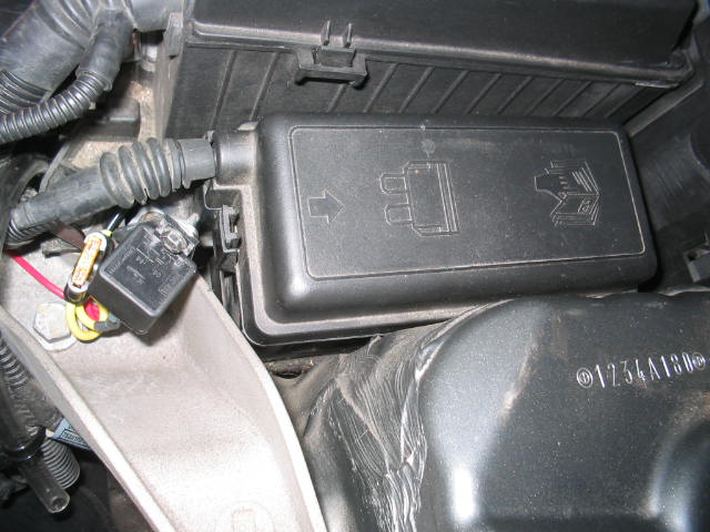

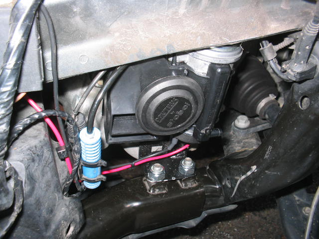

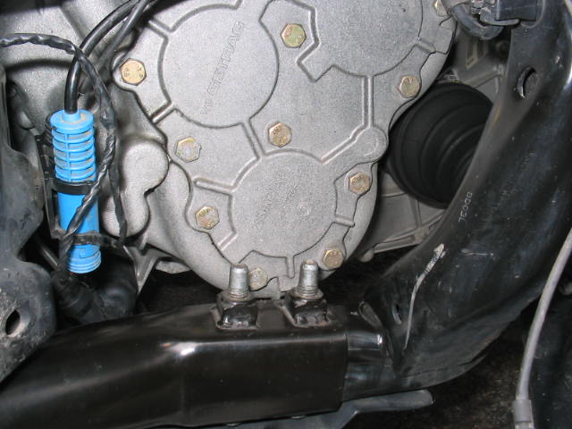

Installed STEBEL NAUTILUS HORN
Found a place, they are definitely louder than just the OEM horns which I retained.
Attached Thumbnails Anyone replace their MINI horns with this one?-101_0160.jpg   Anyone replace their MINI horns with this one?-101_0162.jpg   Anyone replace their MINI horns with this one?-101_0163.jpg
