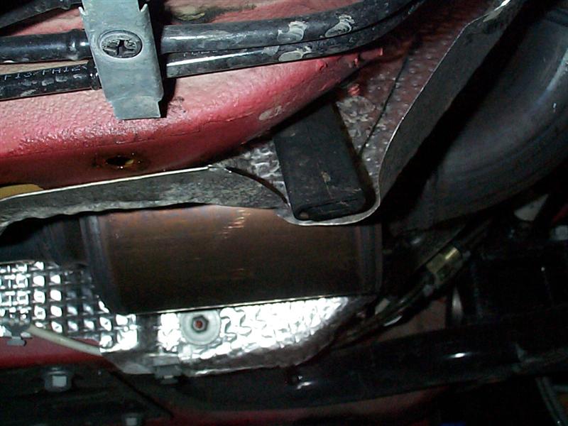

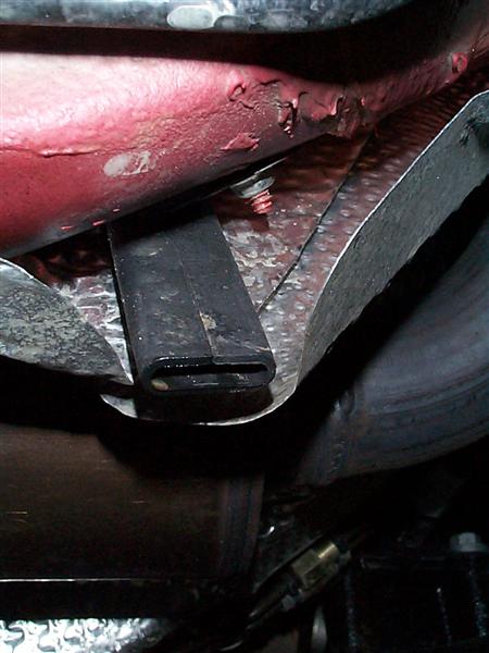

Can anyone tell me what the black oval hose/tube is - it seems to be dripping fluid when I stop when I drive in hot weather in Los Angeles right now. (There is a close up image, and then a farther away shot showing the undercarrage where the oval hose/tube is)

It's your air conditioner drain tube. The fluid is water that is collected on the coils inside the car. Perfectly normal. :smile:

Thanks GreatBear
I respect your frequent and good posts... I thought so, but I baby my baby....
It is cooking out in California right now triple digit temperatures are looming

Dont think you would want to drink this stuff
not quite water, not quite oil, not quite sure what it really is
