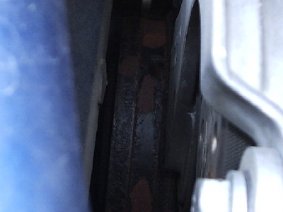

I have a squeeling problem with my Apr 04 MCS when i first take off from a stop. I have narrowed it down to the belt. I noticed that someone said that one of their pullies, crank i think, has chipping paint. Isnt this normal, i have it too. If it is not, i would like to know.

Ok here is a pic of my flaking pulley, i dont really know which one it is.

thats the dampner pulley and no it shouldnt be lookin like that.

What would a dealer do if i told them to do something about it? Tell me that it is cosmetic and not to worry? Or is it something minor that i shouldnt take the risk of the dealer screwing up?

It doesnt matter how bad or long it should take us.....If there is a problem with the vehicle they should take care of it and not b.s you.....The pulley should not look like that with missing paint......thats def not normal wear and is takes nothing to change it.

Thanks, ill have them look at it the next time im in. BTW, is there anyway they could say its pulley related. I dont think so, but you never know.

ive heard worse but i doubt it.
