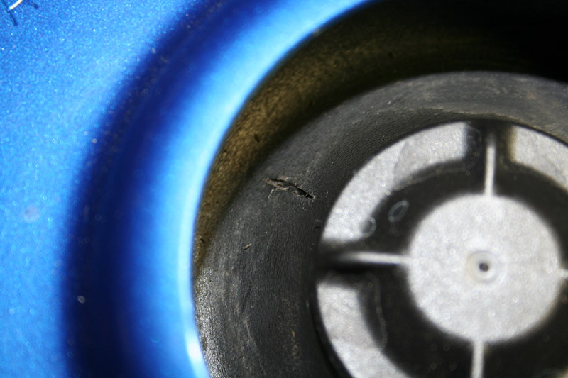

After reading this long thread, I decided to check my 06 MCs, @#$%^&* a b#$%^ch, my driver side mount has a crack. I cannot believe after just 1600 gentle miles, can't remember hitting any big potholes, the mount is shot. I guess I will need to contact the dealer. Is this a sign of worse to come if left alone? Thanks.
Attached Thumbnails how many cracked upper strut mounts?-img_0800_1.jpg   how many cracked upper strut mounts?-img_0799_1.jpg
Not quite sure what your crack resulted from but here a look at a manly crack

Wow, that's quite a crack . Did you get it fix? Any mushroom grown? I am thinking of waiting to see if that gets worse, but at the same time, don't want to turn into a shroom grower. Any advise here?

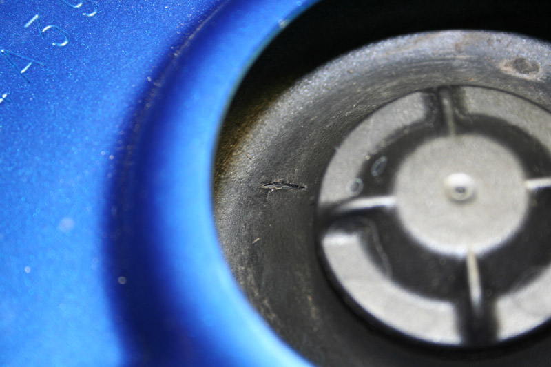

[quote=Dave]The change on the 2006 was to the strut upper mount, not the tower itself. That change appears to have been made to address the cracked upper strut mount problem. [quote]
Sorry Dave, 06 still has the rubber mount problem. I just found a slit (crack) on my driver side (see pic posted above). I am deciding whether to take it to dealer or not.
Sorry to hear that. Hopefully the '06 strut mounts at least prove to be "better" on average over time, even if they aren't "fixed."
BTW, all I was trying to point out above was that MINI changed the strut mount, not the tower, so mushrooming still remains a concern.
