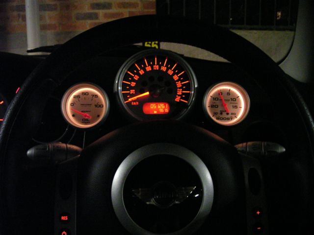

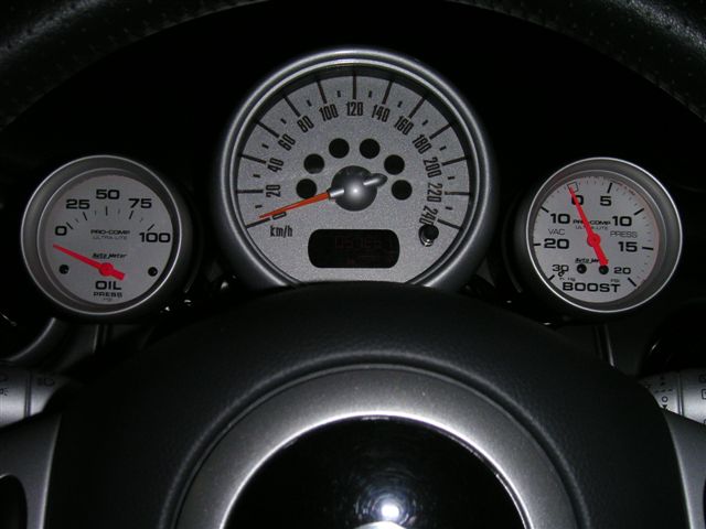

I installed my boost/vacuum and oil pressure gauges (Autometer Ultra lights) a couple of months ago and have found watching them really interesting especially from the point of view of being able to see what the electronic throttle butterfly is doing which gives some indication of how the engine management system is set up and why the cruise control is so bad.
One question I have though is do you reckon the boost/vacuum gauge would also give you an indication of the condition of the air filter? My car has about 55,000 Km (just over 34,000 miles) and as far as I know the air filter has not yet been replaced (I've only had 2 services). I only manage to get a maximum of about 9 psi boost at redline yet I've from what I read on here people seem to be getting more like 11 to 12 psi at redline. The car runs fine, I've double checked for leaks in the vacuum line and I manage to get about 20 psi of vacuum so that would seem to rule out a leak. Any thoughts?
The photo with the lights on doesn't do the lighting of the gauges justice. The gauge lights are whiter in appearance and more evenly spread over the face of the gauge.

I smile every time I see an Aussie MINI gauge setup.
A dirty air filter can indeed cause a reduction in boost, as it restricts the airflow entering the supercharger. You wont notice an increase in vacuum though.
Other factors contributing to low boost pressure in MINIs can be loose/leaking intercooler boots, slipping belts and defective or misadjusted supercharger bypass valves. The weather plays a part too, low barometric pressure and hot, humid days can reduce the ultimate boost seen.
You gauges look great! Fair dinkum!
