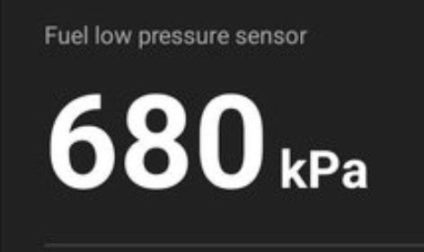

You previously posted a reading of 680 kPa (98.6 PSI) from the fuel low pressure sensor. Normal pressure from the LPFP is ~72 PSI, suggesting that your LPFP was producing higher than normal fuel pressure rather than lower than normal fuel pressure. These observations seem inconsistent with a LPFP that can't build pressure. Did the Bimmerlink reading from the fuel low pressure sensor change after the new O-ring was installed?

Yes that's a good point.
I'm skeptical and will query it again when I collect the car on Monday but if that's what he's telling me there's not much I can do about it. I'll check the reading again when I can.
