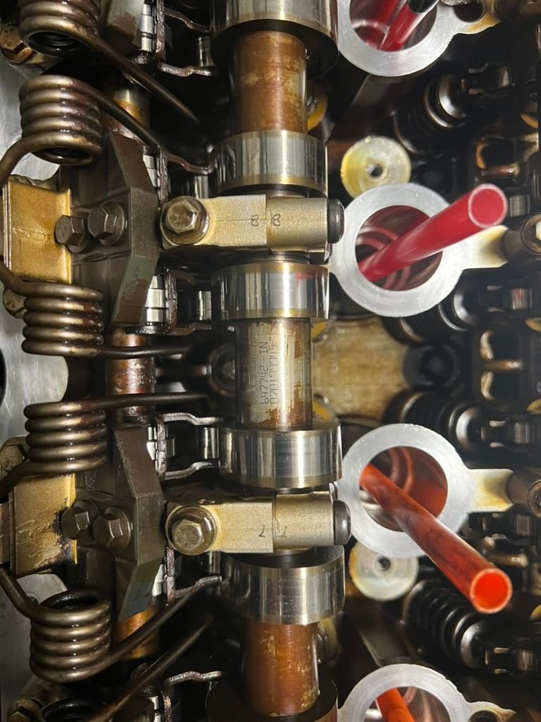

I put straws in the spark plug hole and checked the timing, with the cams writing straight up and the pin in the crank to find that number 1 and number 2 are not even, they are close but not perfectly flat. I assume this means the timing is off and the reason for my codes? but how could that be if the tools locked properly on the crank and the cam tools went right on. does this mean it has to be in time ? anyway I am at a loss and worried about hurting the car so i have not driven it since. I am down to tear into it again (really hope i don't need to after 7 days of wrenching on the entire project) but will if you guys can tell me what to do from here or if i am missing something in the process that will fix this via software.

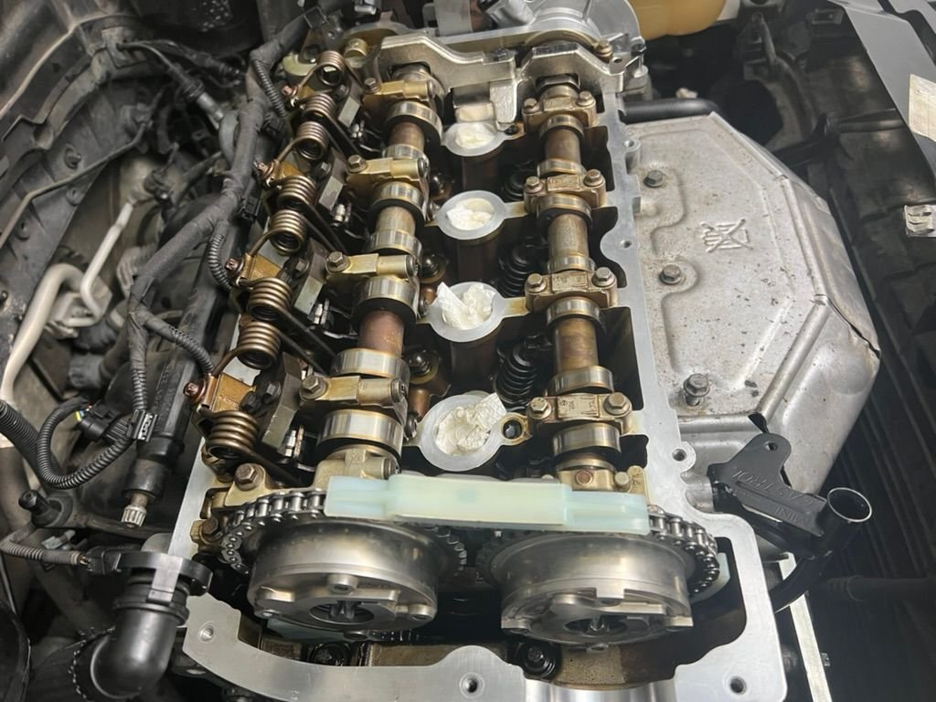

OK guys, I got new bolt and re-did the crank lock first, pin was in straws perfectly lined up. Cams were off. I broken them loose and reset the cams, cam locks went on beautifully dropped straight on. put everything back together as mentioned above and per the mini specialist. reset adaptations with my schwaben Foxwell tool. Waited 10 min after completing this and then ran the delete vanos adaptations. it had me start the car and run it for 1 min and recorded the intake and exhaust values and guess what. they did not change at all. I got exactly the same numbers i had after the timing chain replacement.... What they heck is going on? I the intake is still at 133.80 (should be 140- 160) and the exhaust is still perfect dead in the middle of the range.
I have no idea what to do next. thoughts ???

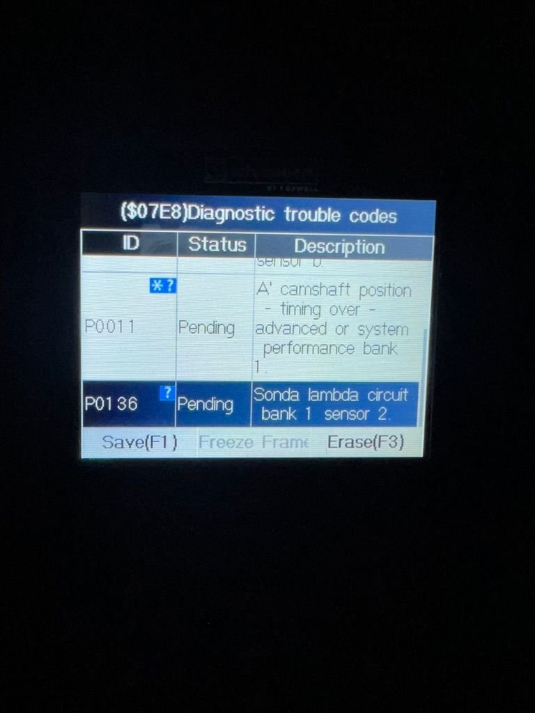

Post the recent fault code(s).
The fact that a fault code follows the VANOS solenoid currently installed on the intake side strongly suggests that the latter VANOS solenoid is bad.

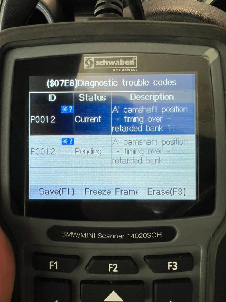

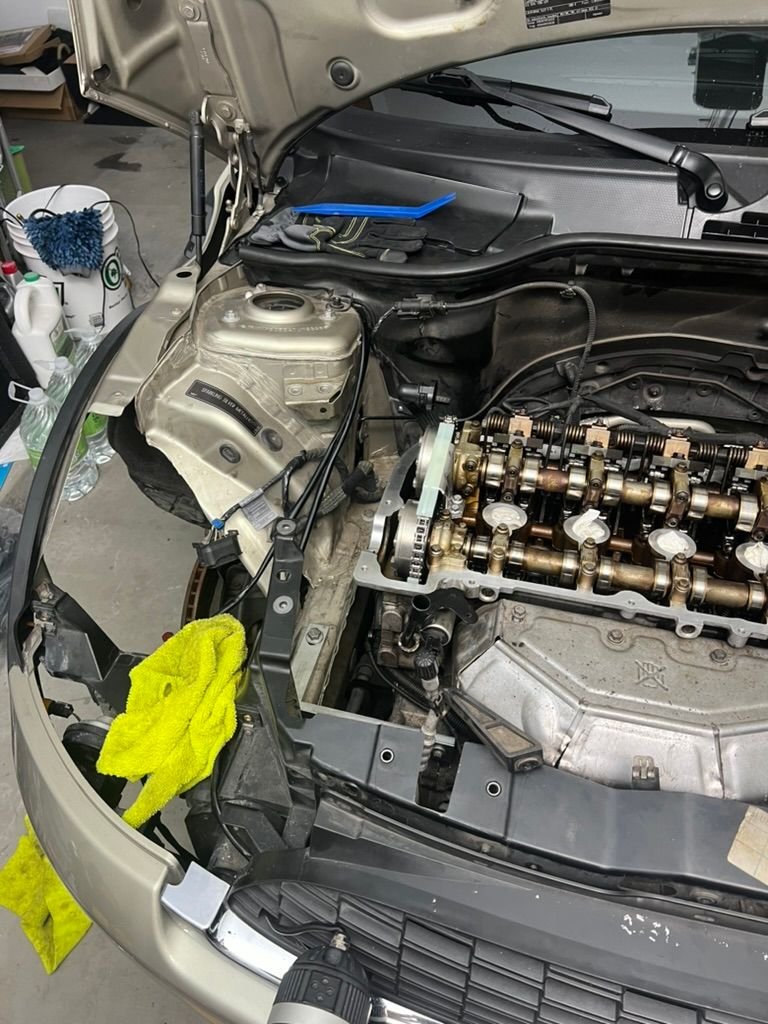

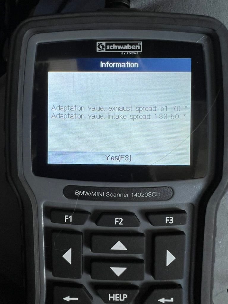

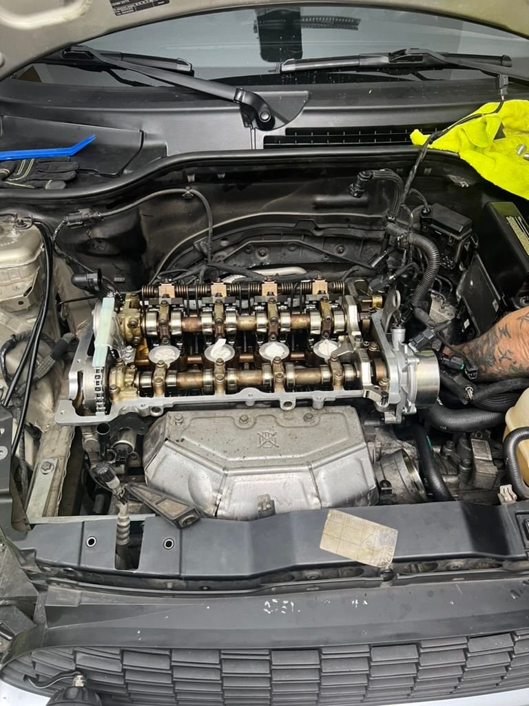

I dont have any vanos codes. swapping the solenoids didn't reveal anything did it? I am wondering if the reset is not actually happening on the schwaben foxwell tool? I still have the same values I had before retiming the engine. 133.8 intake (should be 140-160) and 51.70 exhaust (should be 40-60). i did have to move the cams to get them into the perfect spot now that i used the straws to know the crank was properly in position and locked. I guess it was not in all the way the first time or we just timed it back to the old spot from the worn chain and parts. but it's really running rough now and that code popped up in less than 2 min of idle in the driveway,with a strange surge at one point before the code was thrown.
i have pics of the codes and the cam positioning so you can see how its lining up. i have recorded some live data that i took pics of but not sure if its vaulable or not given the values move around as its running but happy to post.
This is the new Cam Timing Code that popped up after starting the car. after cams were re-timed
top down of both cam positions
Cam Position Intake after retime
Exhaust cam position after retime

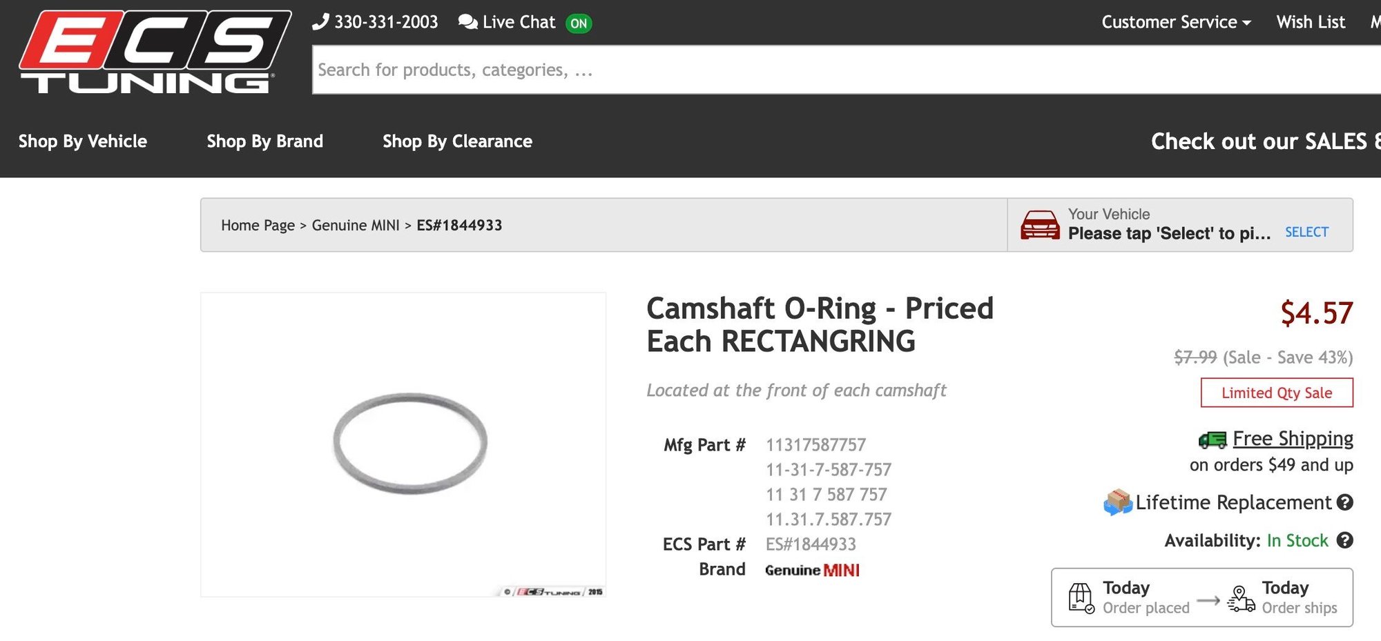

Have a look at this video (rectangle rings):

I watched the video on the rectangular rings and realized I’ve seen that video somewhere before. I’m hoping I don’t need to pull the cams out of the car to replace them, but I will if I have to. I’d like to explore all other possible options before tackling that job—it’s a bit intimidating unless I can find clear instructions and know exactly what supporting parts should be replaced at the same time.

This has to be the most unusual car I’ve ever worked on. Yesterday, as I was leaving work, I decided to plug in the scan tool to capture some live data. I noticed pending codes and deleted only the two camshaft-related codes without performing a full system clear. After that, I started the car.
To my surprise, the VANOS system immediately came off the stuck value of 120 and began operating as expected, dynamically adjusting with respect to RPM, load, and other parameters. Since then, the issue has not returned
I have no idea what suddenly resolved the problem—perhaps one of the countless parts I’ve installed recently—but for now, everything seems to be functioning correctly. While I still plan to replace the rectangrings eventually, I’ll hold off for now since the vehicle is finally operating as it should. How long this will last remains the big mystery.
