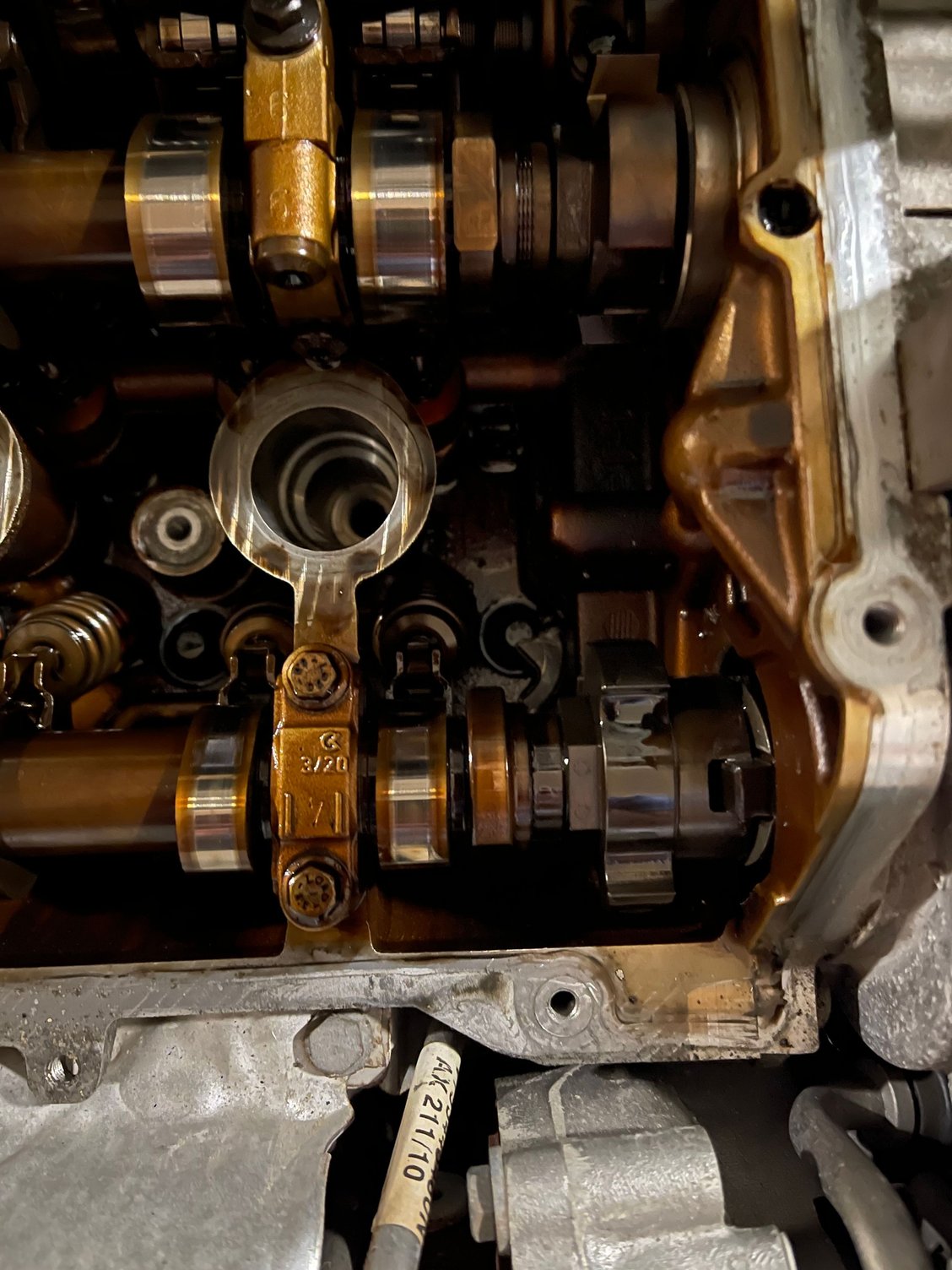

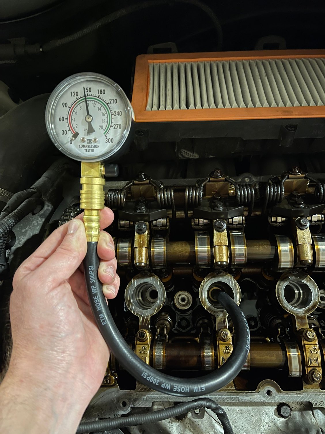

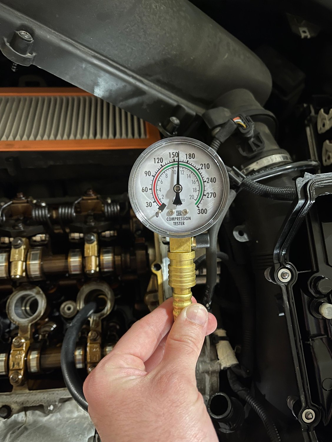

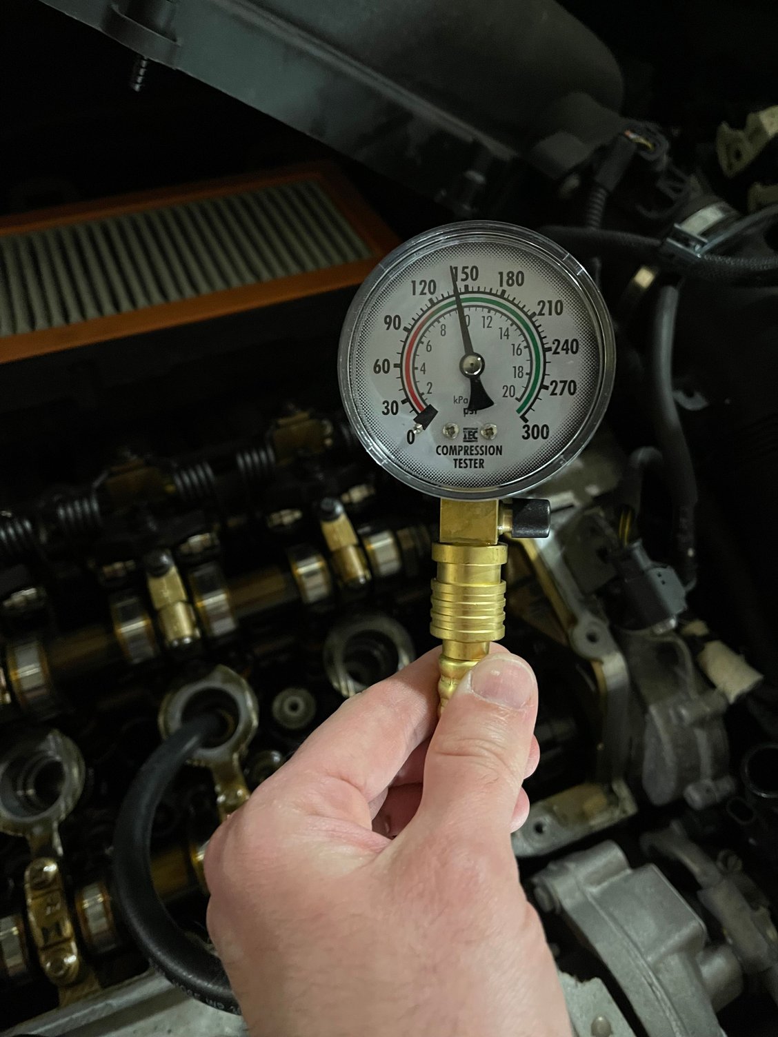

This essentially led me to consider the timing had jumped and possibly damaged the valves/pistons. Que the compression test.
Compression looks good on all cylinders (I removed cover after I couldn’t believe the results. These are retests)

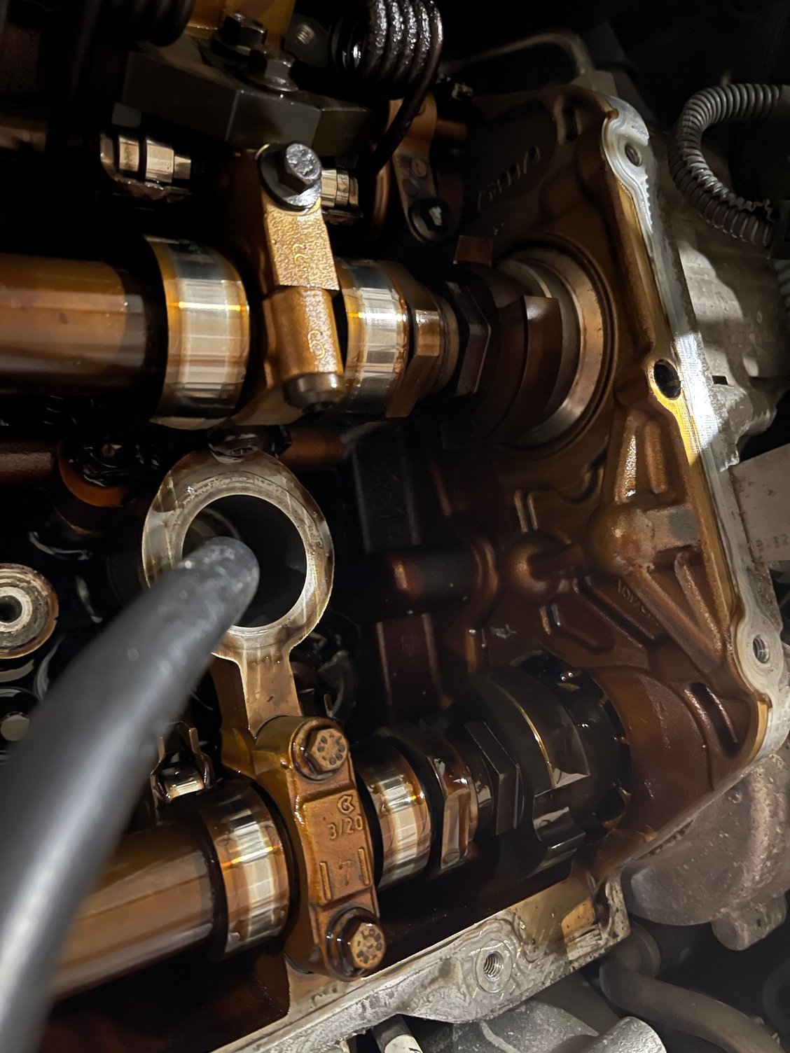

The timing chain is tight with zero play and there are no metal shavings in the oil. The chain guides look like the old version but seem like a newer install.

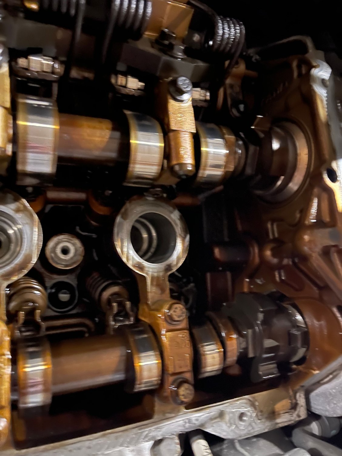

I then noticed the timing blocks on the cam shafts are nowhere near being lined up.
Correct me if I’m wrong, but these need to be parallel to each other when the chain is installed otherwise the car won’t start and/or run like crap.
I just don’t see how it is possible for the car to “lock up” while driving (so I was told) and have zero signs of internal damage, yet also be so far out of time with zero chain play and what appears to be zero valve damage.

Solved the problem. Turns out I was correct about the previous owner doing an abysmal timing job. The cams were never aligned with the timing marks indicative of someone doing a timing chain without the cam locking tools.
