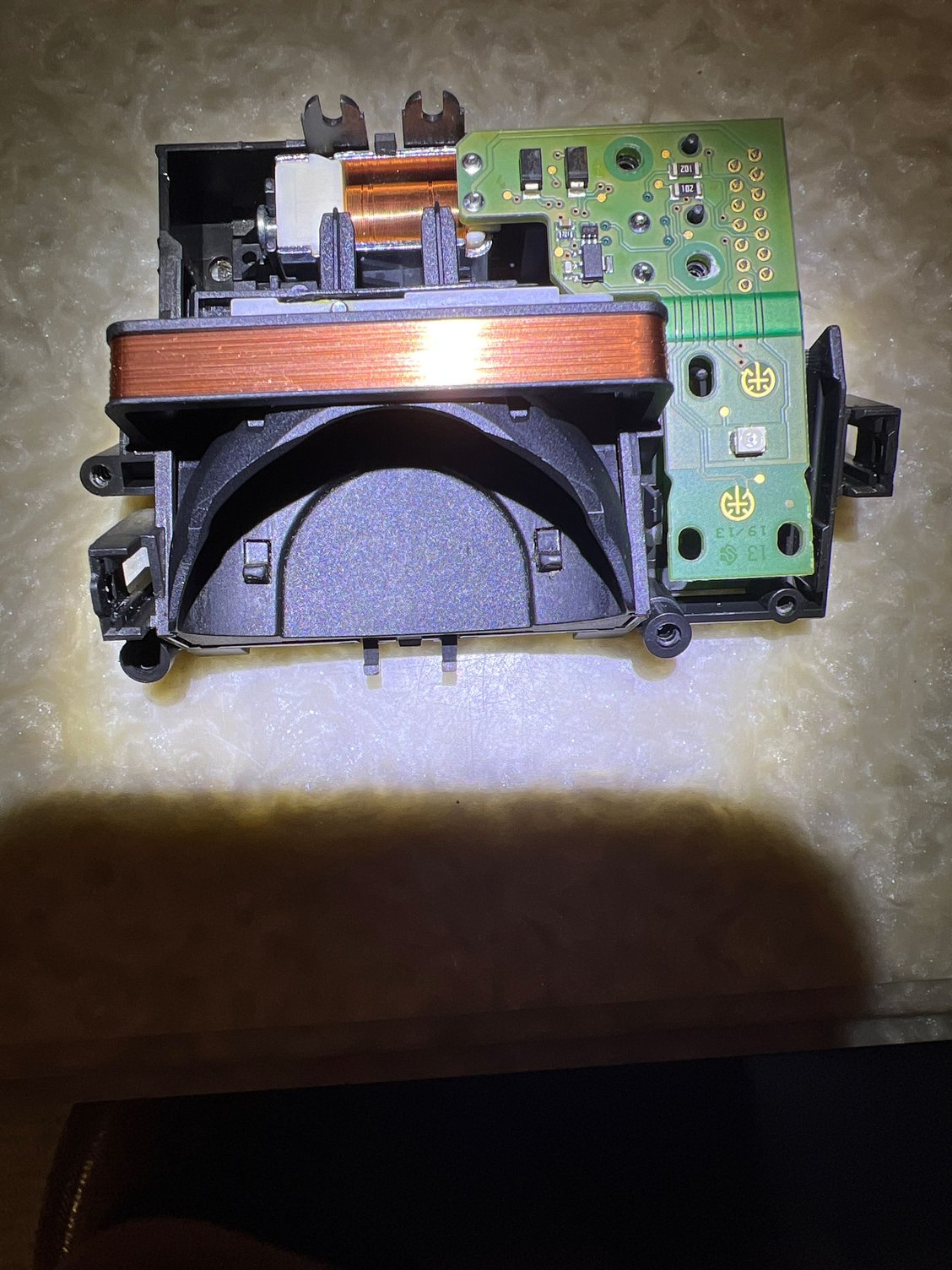

Was left stranded today due to a key. Thought it was a battery. Could still unlock and lock the car, but the car would not detect the key. Trying to get home, I got the key fob open took out the old battery and put in one that was not a rechargeable battery. Same specs just not rechargeable.
It locks/unlocks, cool. Insert of the key, nothing. Insert the key again worked. Got myself home.
Fast forward. I have a brand new ignition switch from the auto parts store and actually looks identical to my original one down to the sticker and stock photos of oem stickers.
Anyway, the brand new one will not eject my key. Now my original will not eject the key…..
What’s going on here?
I have the car on a charger to keep the battery from draining, I already have new keys on order.
I have to have the original ignition swi
tch disassembled to get it to eject. Car has power and was driving fine today. Just wont recognize the key or eject it and the new switch wont eject either.

Key troubles
No, not at all. Plugged it in. It lit up, took my key and said NOPE! MINE!
after disassembling (beyond the photo) and putting the original back together. It ejects now… im going crazy with this thing…

after taking apart the switch, it is completely mechanical. After getting my original sorted out by disassembling and reassembling, it will eject. Regardless of power. There is no actual electronic locking mechanism in it, it is all mechanical. If you look at the photo attached, you’ll see that on the white horizontal bar there is a tiny metal “tab“ sticking upward. On the cover, there is a special path on the inside made for it that it goes into. When you push in, if follows the path into a slot where it would be locked in place. When you push out, it then continues onward and then circles back, which is where your key would be when it is ready to be pulled out .
i could be wrong as I am pretty tired but that’s what i seem to remember from earlier

Just noticed how hard it is to see, and how compressed the photo turned out.

Oh, okay, a mechanical rather than electrical issue cause by the fob. How does the fob interact with the tab (or does it)? How is your fob damaged or worn to prevent the tab from circling back?
Does your fob have a metal or plastic ring around the perimeter? Mine has a shiny metal ring like this one:

it’s missing the ring, however, it has been fine for a WHILE. I’m genuinely unsure what the issue was. I put it in like normal.
I will see if I can get more photos and a better explanation when I get back to the ignition switch. Wish I had taken more photos when I was disassembling and reassembling. May have been helpful for those in the future.

The missing ring is potentially the problem. I thought I read somewhere that a replacement ring can be purchased.

It appears as though it gets its alignment from the bottom of the key. And with the ring gone, it does not appear to impact it’s alignment, which makes sense because I’ve been able to use the key fine before.
