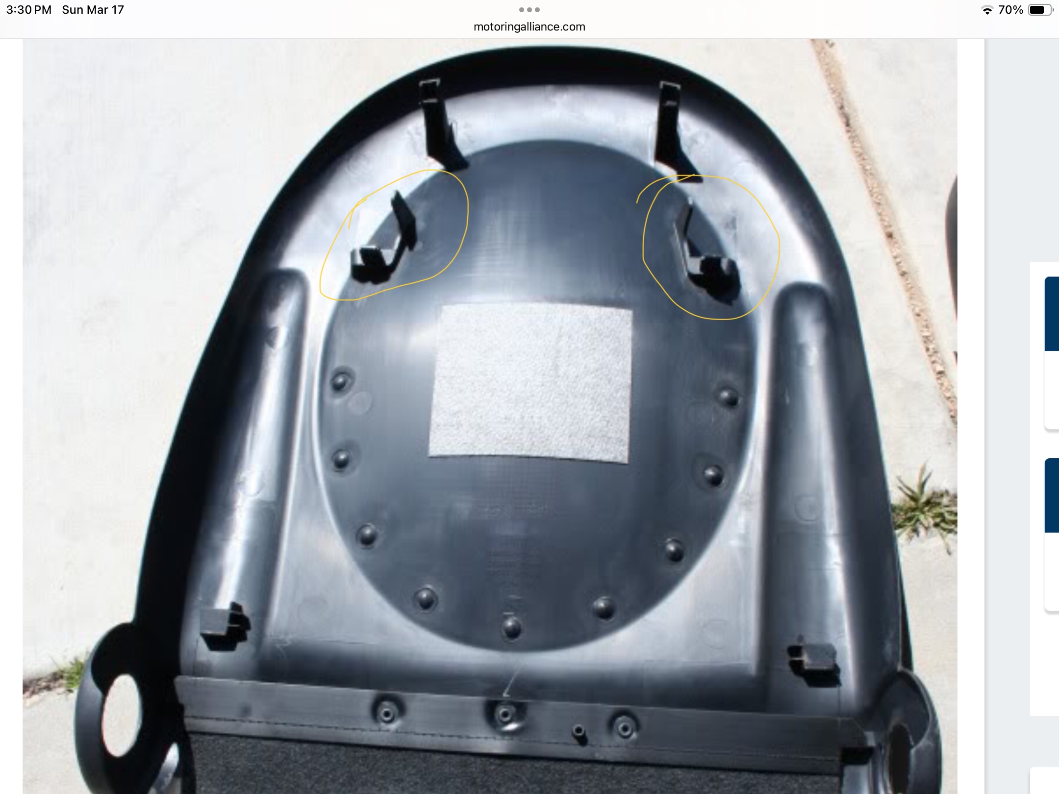

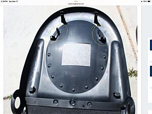

I had previously reviewed the MA thread you referenced. I guess my issue is getting the metal clips to release with breaking them off the seat back, as I will be swapping those to another set of seats. I’m under the assumption that the covers you removed were not being reused, so that was probably not important to you. It looks like the clip actually broke off upon removal, is that correct?

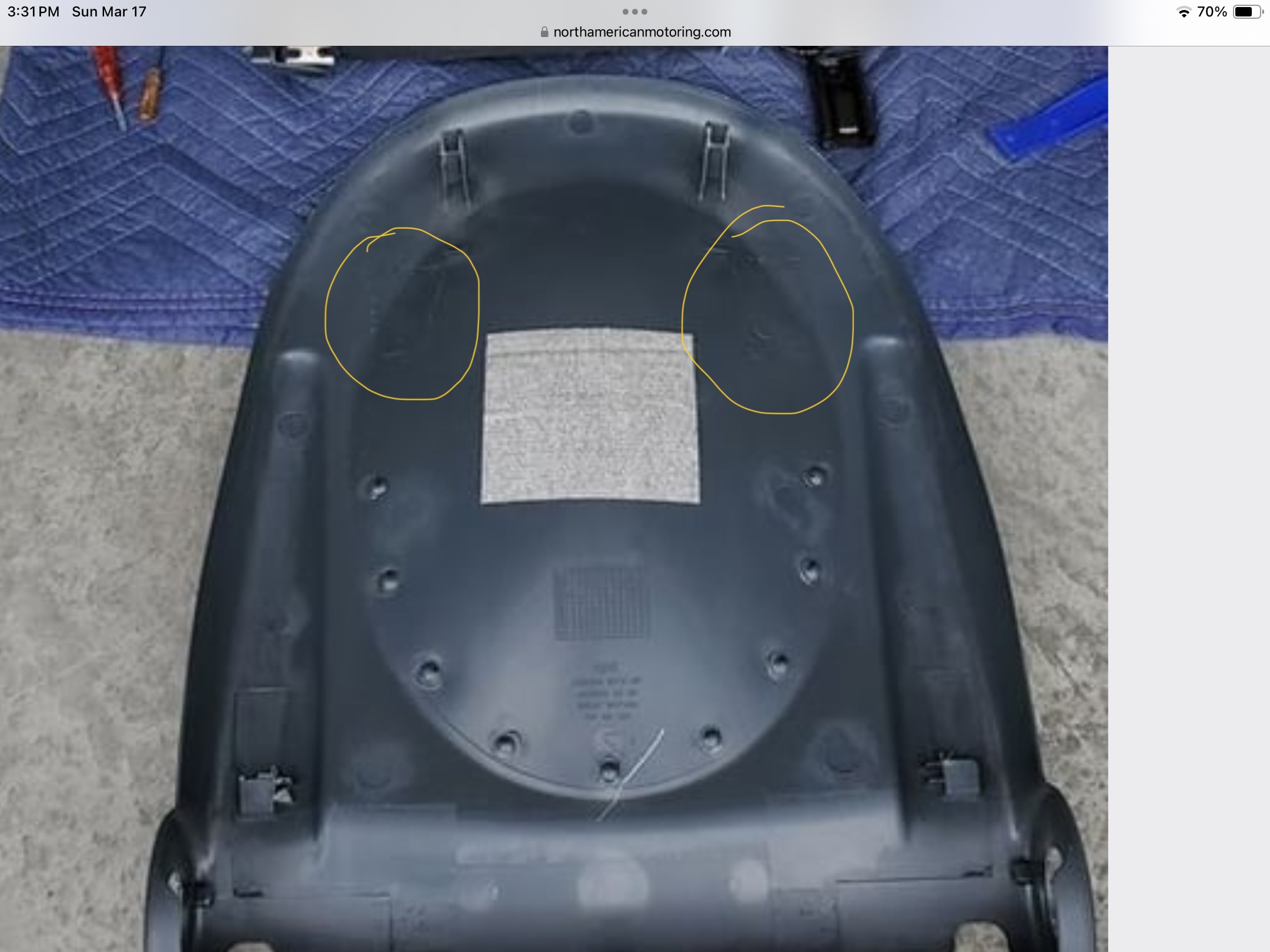

Zooming in on circled areas of my removed back cover shows no breakage as compared to pics in the MA DIY article. Despite those being destined for the landfill, I was careful to avoid damage to the mating seat assembly attachment points upon removal. Once removed, latching functionality becomes much more clear but then, its been a year since I did that. Looking again at that MA article shows the top "hooks" which must be lifted slightly for release from the slotted receptacles in the (top) horizontal bar. IIRC, I first popped the lower attachments clear which then allowed raising those hooks and gently pulling rearward for complete removal...

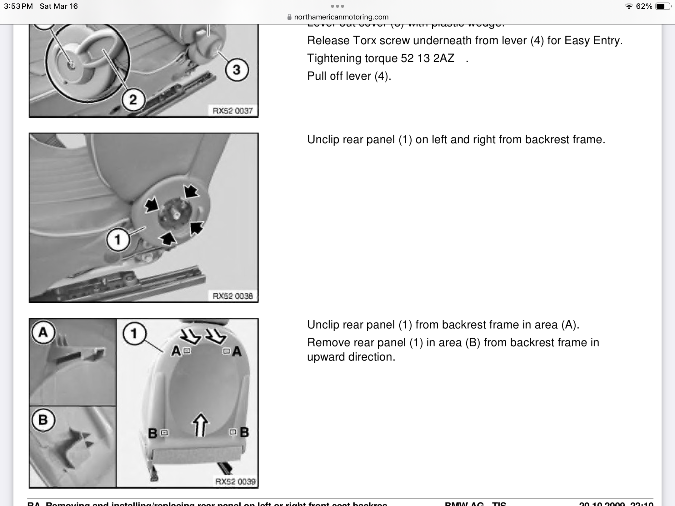

Well, another day, another fail. From your description, you started at the bottom (seat base) unhooked the clips, lifted the shell and push up on the top clips. I can’t seem to even unhook the bottom after pulling pushing up down side to side. From this description (park lane seats) they advise to start at top, pull out, and then lift up to release bottom of shell. I would prefer to use your method because the top clips will definitely deform or break if I just pull from the top. Any other advise on releasing the bottom first?

Yeah, I’m thinking by the diagram, seems as though the bottom needs to be lifted up to detach. Though they specify to do top first, and that’s looking dicey with 20year old plastic unless the clips can be pushed up. Already got a coat hanger in the to no avail 😩 also, I don’t think the 06 had the fabric piece attached at the bottom with the strap clipped to the seat bottom.

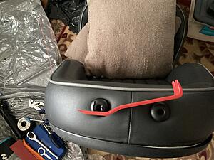

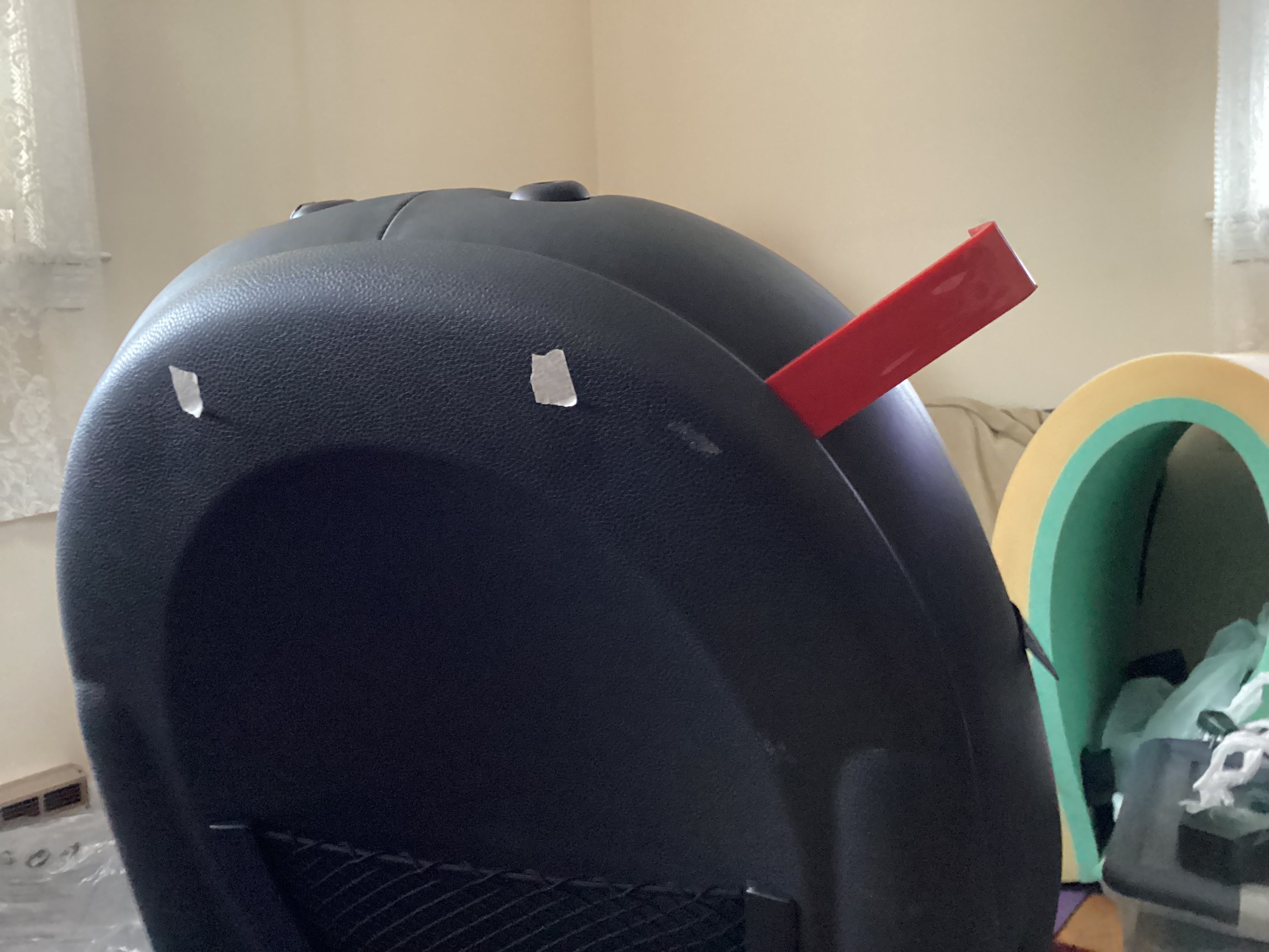

Success! If needed, mark approximate location of top clips. Use a sturdy (thick) trim removal tool that has a good curve. Wedge in from side. Pull back tool so it’s guided to front of clip. Angle (pivot) up with some force while slightly pulling back on shell. Kind of a no brainer to be honest.
