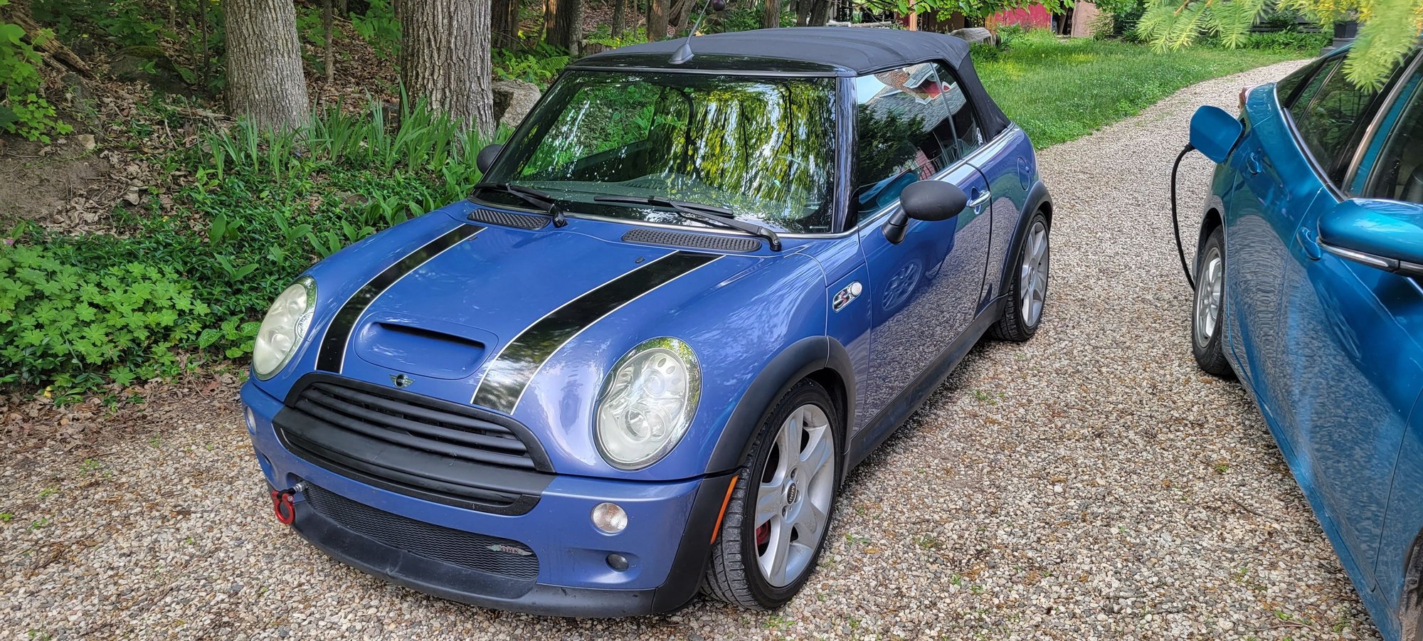

Pictures
I forgot to add some pictures. Thanks for the feedback, it will help me build out the to do list for this winter and beyond. Also, I have a few videos from ModMinis qued up.

Good you put the pictures up. I noticed the plastic coolant expansion tank. Replace that as well with a stainless steel one. The plastic seam will expire...usually at the most inconvenient time and place.
