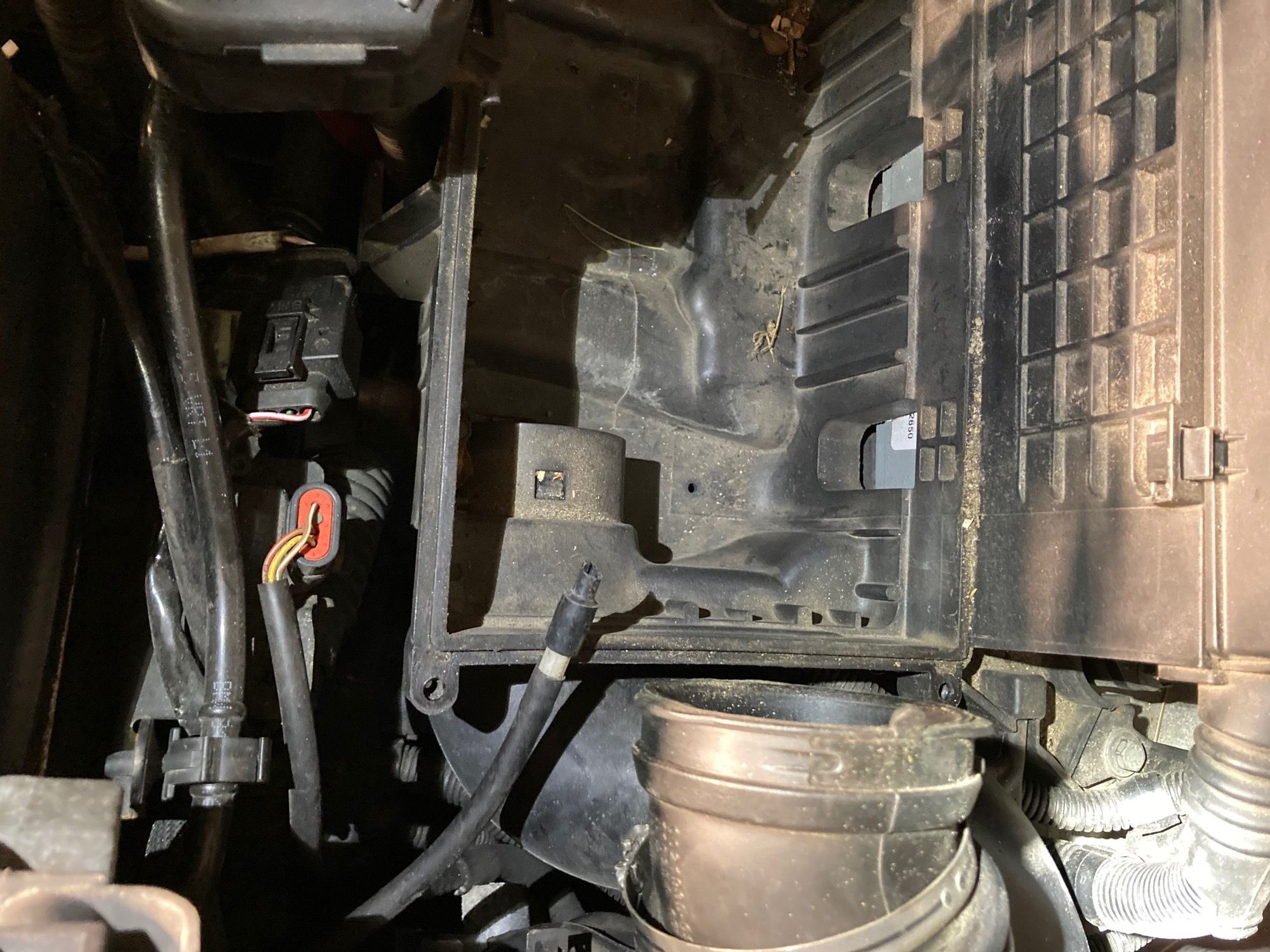

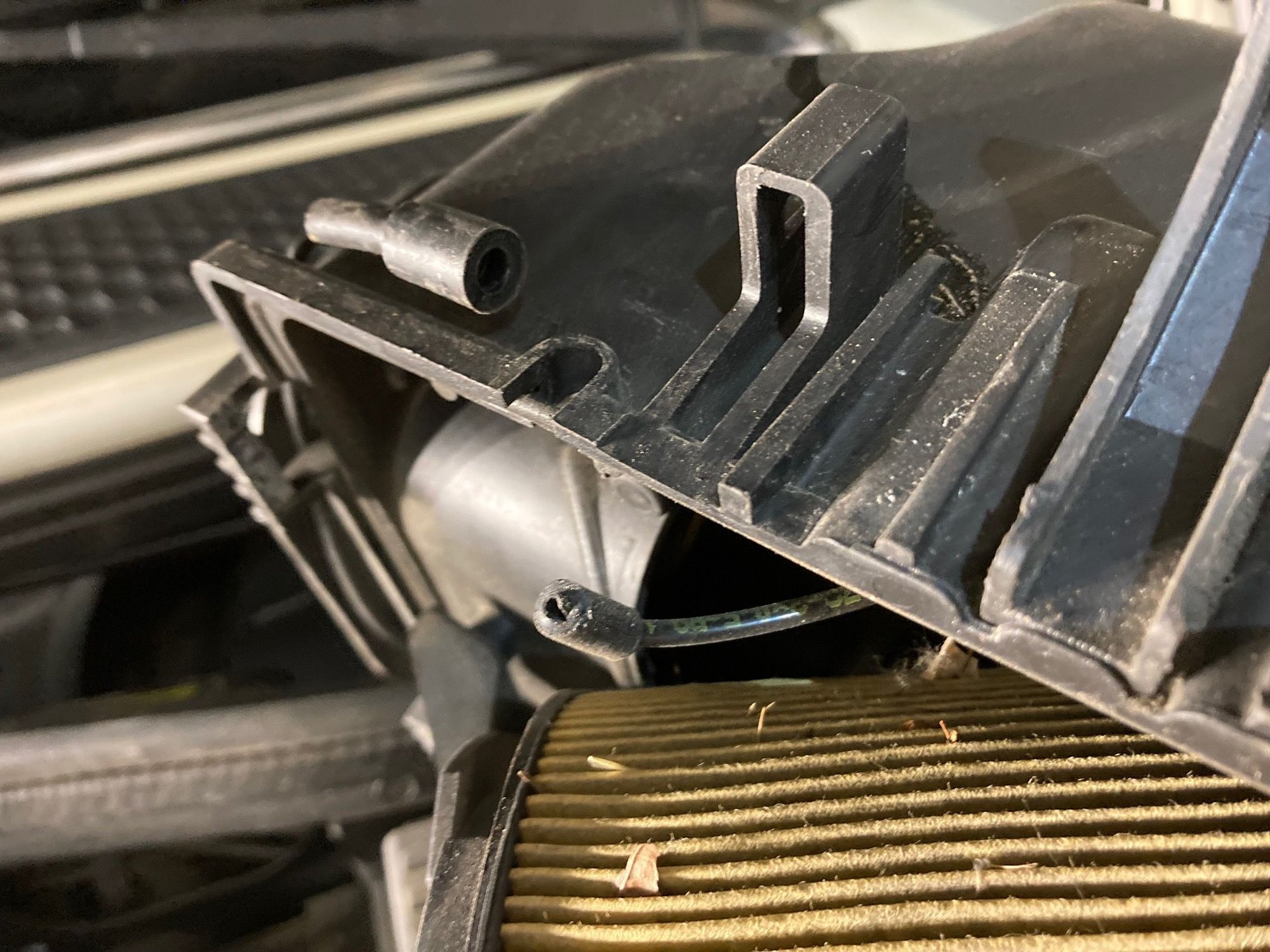

I have an 06 R53 JCW. The flex joint in the exhaust downpipes rusted through about 18 months ago. I replaced it with a Scorpion manifold without a cat. Some time after the work, the SES light came on with the P2096 code, and I've been chasing O2 sensor remedies ever since through using spark plug antifoulers and steel wool. Different combinations have been unsuccessful so far, but yesterday I installed a 90º adapter on the first O2 sensor, but have not driven it yet.
Doing a lot of reading here on the forums made me start thinking about various possibilities of vaccuum leaks around the place, so I thought I'd poke around a little to see what I could find. Tonight I pulled the airbox apart since I have not done so in my time of ownership, and I noticed several vaccuum lines were brittle or partially missing in the vicinity of the airbox. Some photos attached.
Would anyone be able to help me figure out where the lines go?
JCW airbox looking straight down. The vac hose is broken at the joint, but can't find where it's supposed to go. Maybe it just lays inside the airbox?
Don't know what this is but it was attached to the side of the airbox. There is a vac attachment elbow, one branch pointing to the rear and I have the hose it attaches to, but where does the one pointing down go? There is a vac line inside the airbox, I guess that line goes to the downpipe of this 90 degree joint?
Final picture. The vac line that goes to the rear attaches to the back port of the previous picture; I guess the vertical port somehow connects to the tube going into the airbox?
Any thoughts are appreciated. What size hose is it?

Found this on another post and it shows me all I need to know:
