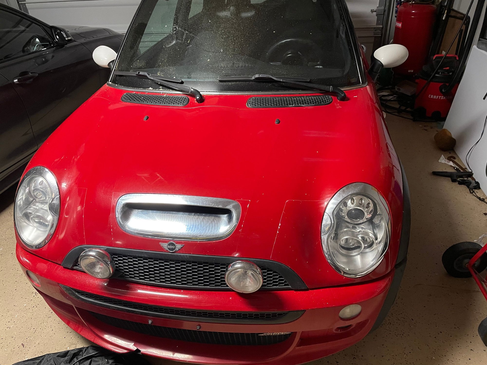

in short, saw a 6 speed manual JCW exactly a week ago on FB marketplace 4 hours away, so we all went up there, struck a deal, amd drove it home.
today is our first day working on it, so we went and got bulbs for the ones that were burned out at auto zone, new cabin filter, and just got back from junkyard where we managed to find a really good condition, nearly new set of taillights to replace the broken drivers one and the not good passenger side. They need a good polish before we put them in but that will be one item of the list needed before inspection and registration.

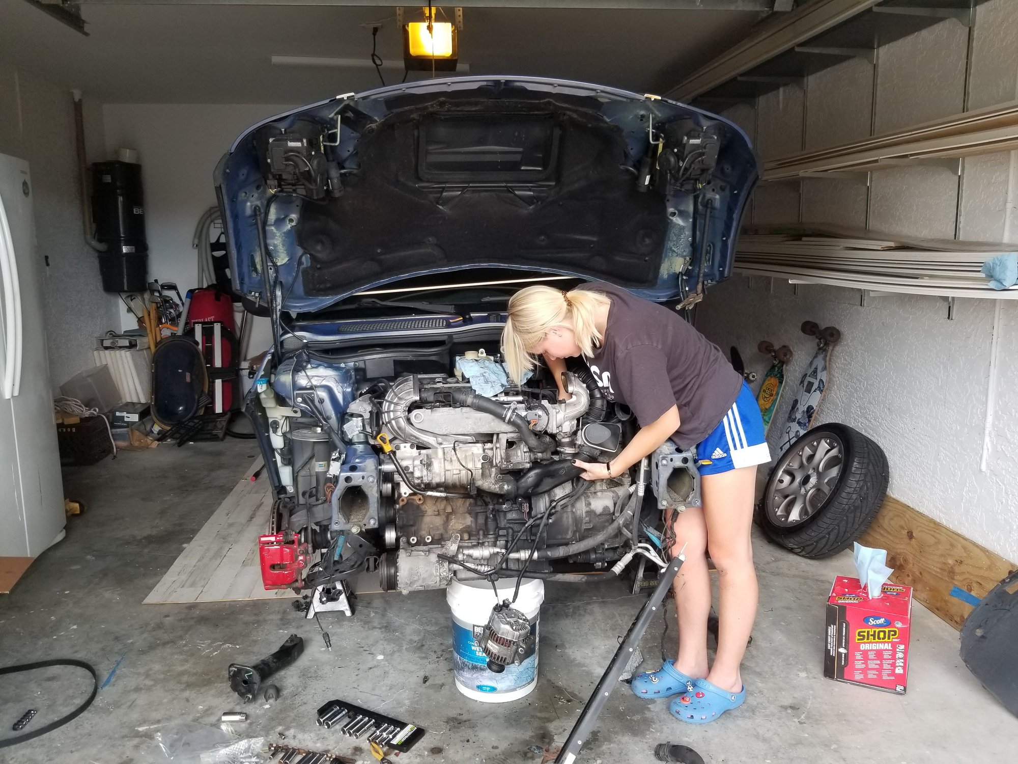

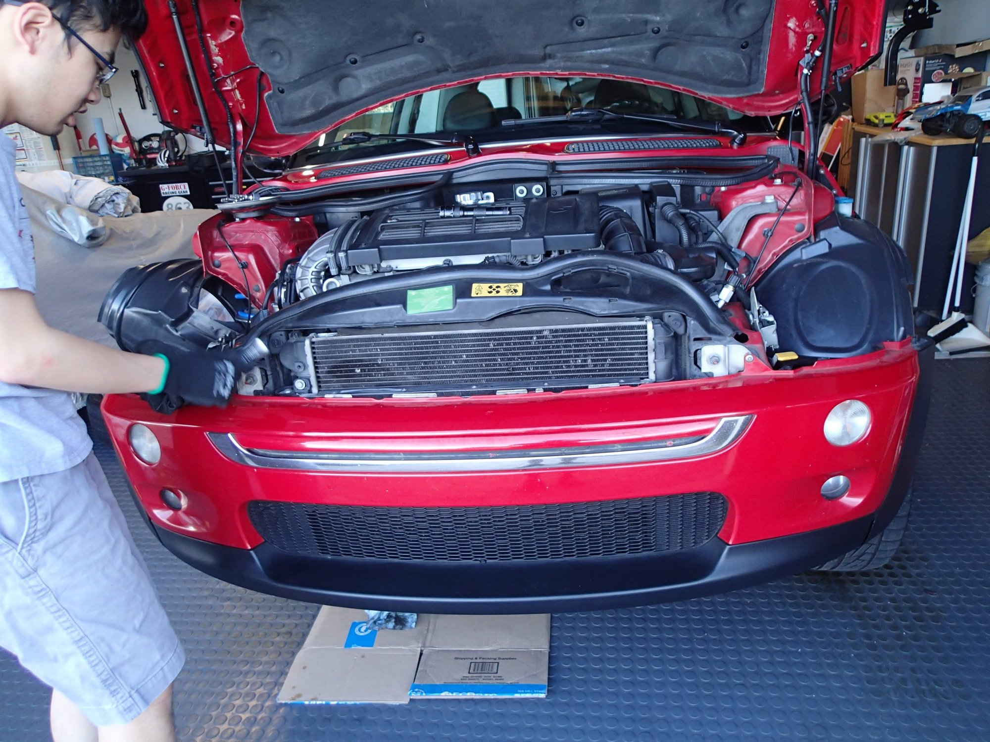

Day two report: here is where we started the weekend as far as errors:
A slew of errors in DIS.
we pulled the IC and JCW box out & that’s a pita. , had to pull ecu to get it out because I was SURE I had seen an unplugged vacuum hose some where this last week but couldn’t for the life of me find it again and I was feeling sure that was the cause of the vacuum leak code.
so in we delved into the mysteries of the W11 engine bay together and started figuring out how to take it apart. It’s tight but very cleverly packaged.
While doing so we discovered it has the Alta foam filter and JCW box was already de-flapped. And it was really oily and grimy so it got washed (both filter and lower box) also cleaned up the IC and ic “horns” outside with some purple power and an old vibrating toothbrush. The combo works great and then a rinse with simple green and a wipe down leaves it looking much cleaner. Didn’t find any unplugged vacuum hose but the JCW mech had to be getting it from somewhere, right? then my son found it again. Apparently JCWs use a T off the CBV unlike the normal r53 I had gotten the tails off yesterday and whose super charger as off and easily inspectable (so I did). (And no the only ones with rear fog had them removed. I looked!) I remembered it being simple short rubber line and here was one with an OEM looking Angled T and one end going nowhere.
once I knew what to google, and old thread here confirmed my suspicion.
the line from the t’d on 4” length of hose to the air box top was completely gone. That was the air leak. I don’t play golf to do a golf T mod, but had a few of those freebie short Allens, that come from flat pack furniture in my tool box, so we grabbed one that fit real tight and my son stuck it about an inch into the open end of the exempts useless hose as a fix for now to seal it.
Then we figured out how to out everything back (and some PO/prior mechanic had lost the bolt that retains the rad hose to the intake so I need one of those, so headed to realOEM after this post to find PN.)
got out the computer and cleared the codes with pasoft 1.4 (it’s faster than DIS for this) and then did it in INPA too.
fired it up and NO SES light!
called my son to come see! Fired it up again! No SES! Idled for a few minutes, NO SES.

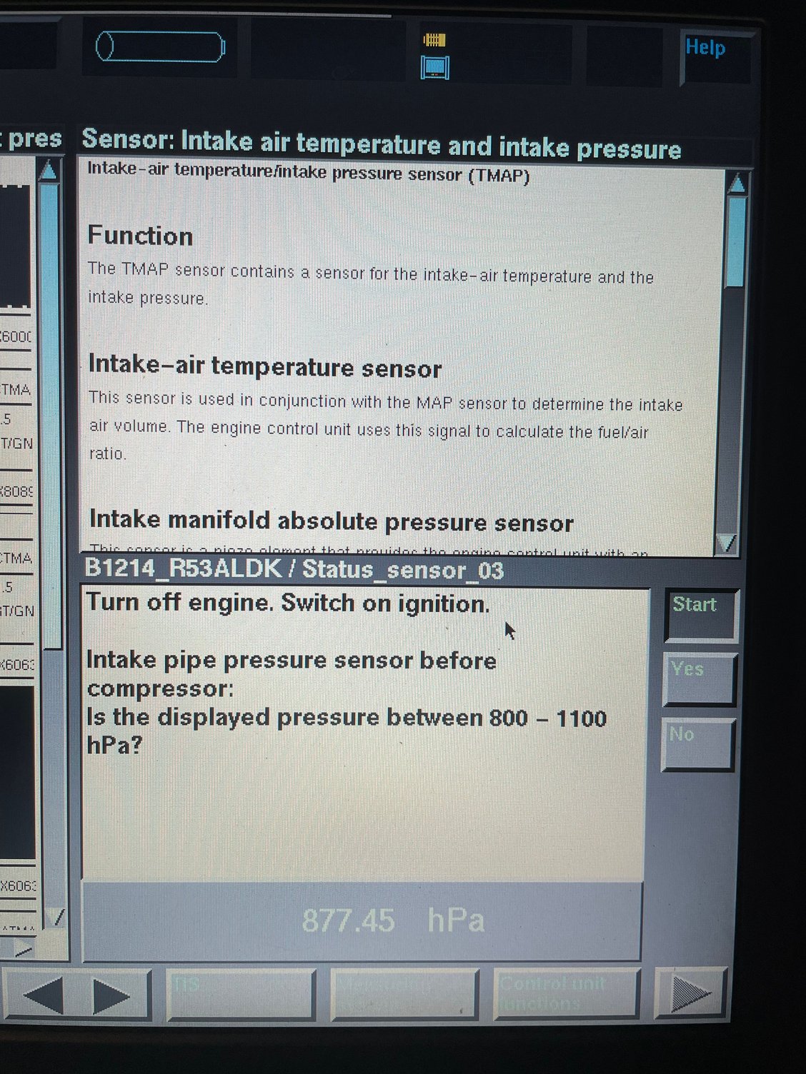

the SES did come back when I got home and took it out of the garage for my wife’s Atlas to come back in, but now down to only one single code.
Down to just 1!
just the 1239, which is probably from what I read that same map sensor the PO replaced with off brand.
interestingly when I tested it seems to read fine off, amd low (255 ish instead of 300 plus) when at idle… but idle is at 1k, not 850. I’m wondering if someone dicked with the mechanical tb stop I saw amd it is a little more open than it should be.
but since it says tmap it’s testing tmap for map issue code? As I understand from loads of reading, 1239 low is MAP by t stat/ airbox, not TMAP.

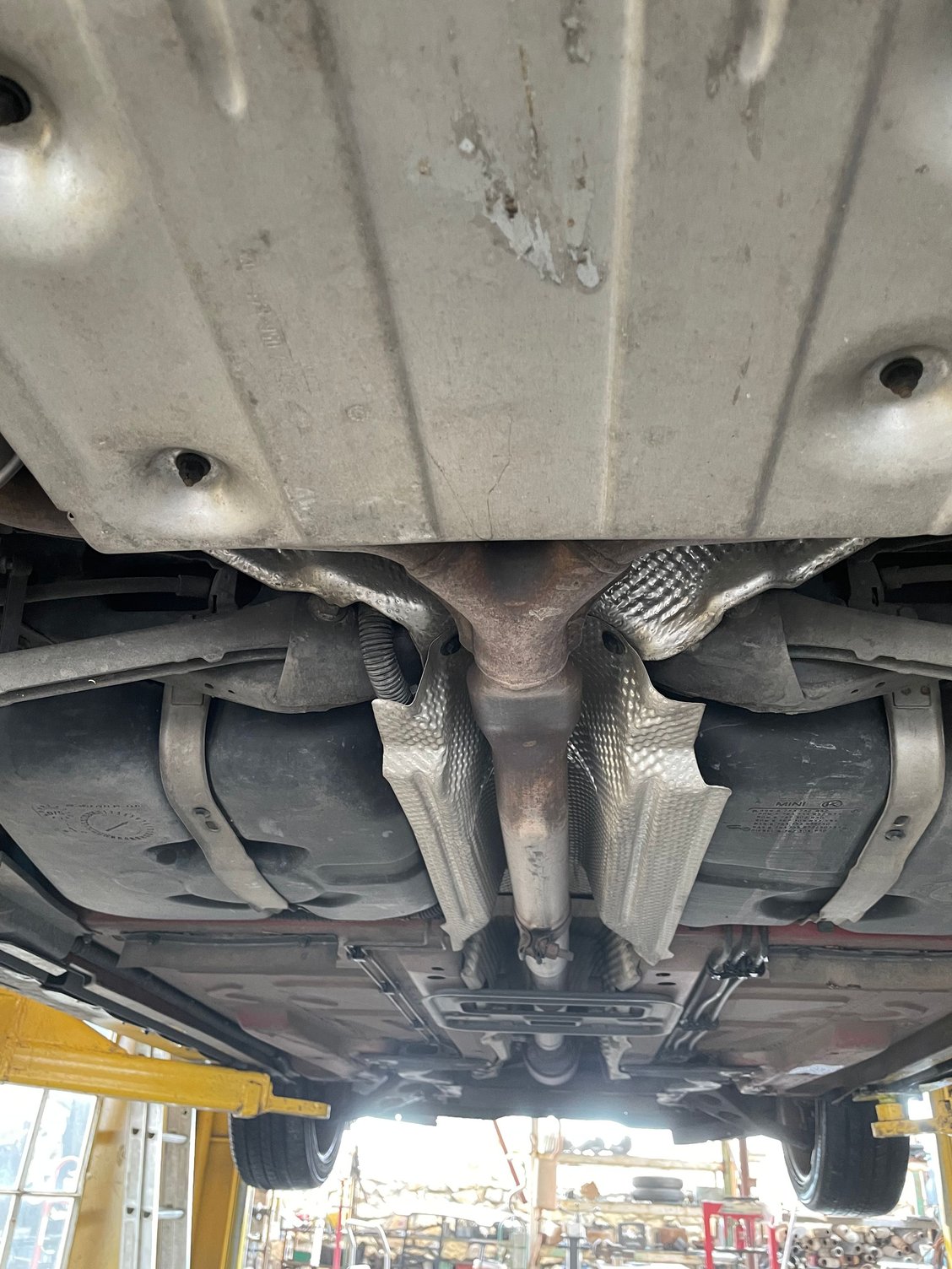

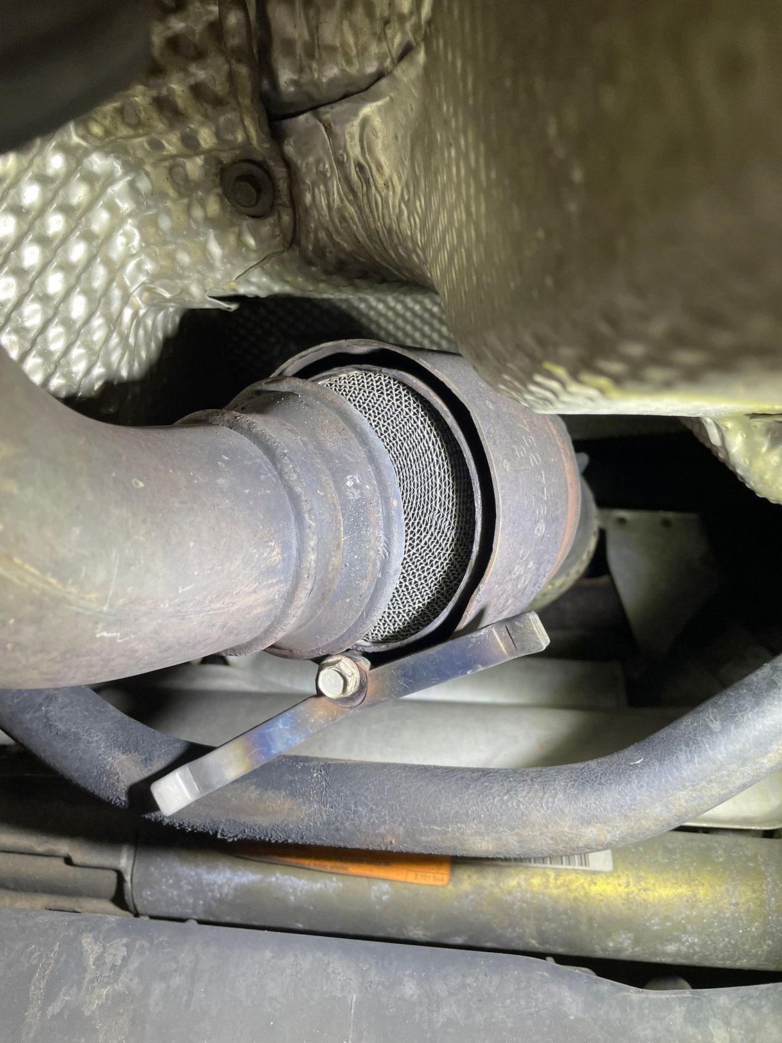

Until I figure out where this exhaust break in the factory manifold is and solve it, my entire neighborhood amd the adjoining ones can hear me coming (and going).
if you’ve ever heard an unmuffled tractor, like a ford 8N… yep.
except this one revs to near 7k.
Reply 1
Aug 8, 2022 | 11:04 PM
It’s probably a broken weld at the pre-cat. It’s not that un-common and is most likely caused by excessive engine movement when the passenger side motor mount fails. Here’s a pic from another thread.

I couldn’t get under it, but I did find my long mechanics mirror and went out with a light to shine down there and yep… I can see the cats white guts thru a rip on the bottom weld.
added both upper mounts and also the drivers side mount to my ecs big order, along with new OEM wires, correct ngk plugs and both OEM tmap and map sensors, OEM wipers and off brand hatch struts. And some white driving light covers and new OEM stripes.
I ordered a rubber wheel off Amazon to see if I can get the old crumbling stripes off.
let’s see if I can find a friendly muffler shop to weld that back up for now.

1: took it to a “friendly” muffler shop to get exhaust welded back. As many had surmised, it was completely a split at the lower precat weld.
we are both really going to miss the 80sTransAm Audi level of burbles and pops on every deceleration of any amount in any gear at any rpm. On the other hand I could hear siri giving directions and talk to the passenger with out yelling and both leaning to the middle.
it ran like Shhhhhh when we left, lots of pogoing and down on power but one it got warmed up and run up the rpm range a couple of times again I’m guessing the trims adjusted or whatever crap was accumulated in there got blown out and the power returned, torque was improved below 2500, especially 1k-2k, amd we got to hear the supercharger for the first time. Not nearly as loud as YouTube videos had led me to believe it to be,
amd if I’m not mistaken, this is actually an S exhaust with JCW tips, not JCW cat back, correct?

That’s a facelift JCW catback exhaust with the flattened pipe at the Y to clear the stiffening brace on the cabrios. All JCW exhausts were manufactured like that after a certain date. Even the GP’s have it. The only thing that looks off is It looks like it has a separate resonated mid pipe. If your car is a Factory JCW it should have a one piece exhaust. The mid pipe was separate on the kit/parts version for ease of shipping. Also, there was only one header and not a different JCW header in case you were wondering. The Aisin auto S’s did have a different header though because the engine is about an inch further over towards the passenger side.
Can you post a close up pic of your front calipers to see if they’re genuine JCW’s and not the “poor man’s JCW” R56S mod?
Re-reading your last post, missing JCW suspension and rear aero bumper doesn’t mean anything regarding the originality of a Factory JCW. They never were available with JCW suspensions from the Factory and the aero kit wasn’t a JCW branded item. The JCW suspension was a Dealer accessory except on the GP and the various aero body parts could be purchased separately.
Reply 0
Aug 14, 2022 | 12:45 AM
Yes, I’ve learned that, it’s factory and on the build sheet, calipers are red and have logo, kinda hard to see em thru the r98s. next weekend can get a pic to confirm when we have to take stuff apart anyway. thought the piping was full round on jcws so seeing a flat section made me think someone sold it off and put stock MCs back on or something.
I think the bulge you are seeing in the front is the main cat? No resonator can on it front to rear,and that was something I was expecting to see from kit parts pics so your explanation that factories are non res makes sense. I don’t know why but I expected the cans to be smaller on JCW so seeing these huge ones and how quiet it is (to us anyway) put that seed of doubt in my mind. Appreciate the expertise!
