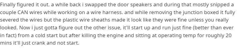

Old Sep 10, 2022 | 11:01 PM
IdahoanCooper's Avatar
IdahoanCooper
Joined: Sep 2022
Posts: 10
From: Boise, ID
