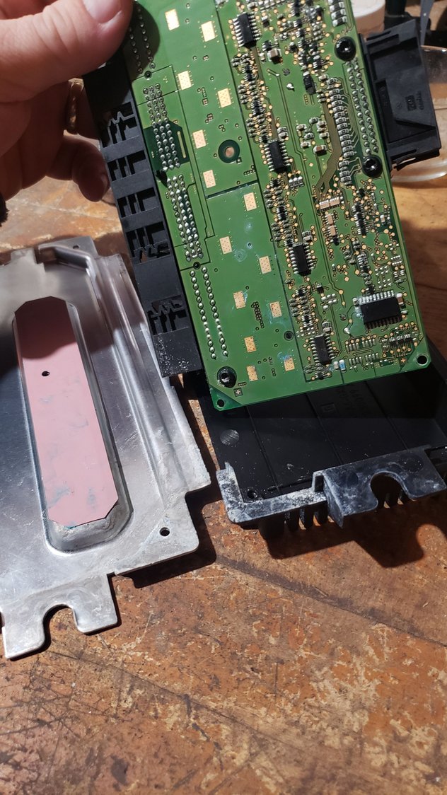

FRM Module wet, foam soaked, corrosion.
any help or suggestions welcome!

Water is no.1 killer for these.
A reprogramming might solve the issue but might want to consider replacing it.
I do programming and coding for these frms or even testing if you want to send it. Pm me for details.

Update,
I cleaned and dried the module and tried it out. No change. I've been doing some reading and now I have a question. Is it possible to find a module from a car with the same options as mine and not have to have it programmed?
I found a few used ones for sale and I live 3 hours from closest dealer
