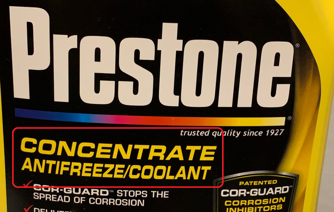

check to see if the a/f you bought is pre-diluted or concentrate ... most a/f at parts stores is sold both ways . . .
the solution should be 50% a/f cut with distilled water, pre-mix will be at this concentration IME ..... the small amount of 100% you'd add won't throw things off very much but why waste money?
a/f is a case where MORE is NOT better ...... TOO much / too high a concentration won't perform as well as the proper mix . . .
folks sometimes make the mistake of filling their car with 100% a/f thinking this is better and then find themselves with cooling system issues . . .
and YES, I've used plain old Prestone to top off my MINIs as needed since 2002 - mine and folks I help out - ZERO problems with a combined mileage approaching 500,000 miles (multiple cars) ... color don't matter and will change as the coolant 'ages'. What you don't want to see is any sign of OIL or foaming.
