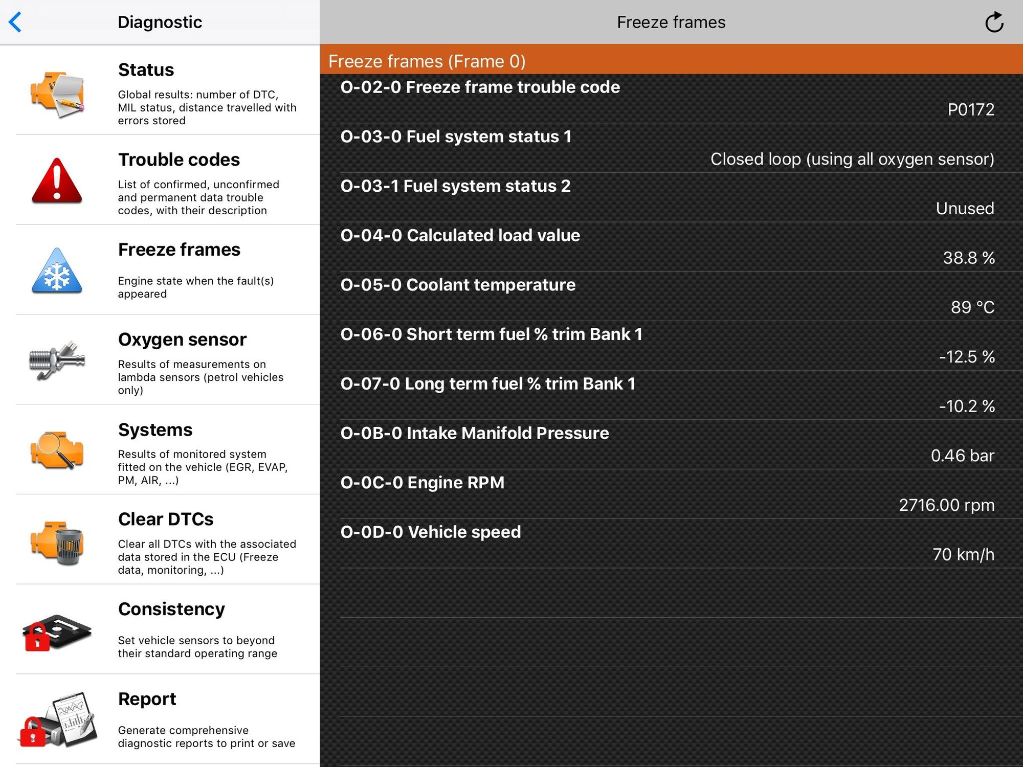

thought id add some possible pertinent info?
Freeze frame data from the p0172
Trims and O2 readings at idle... the app is slow so not a massive swing on s1-1 but in other apps it seems ok
