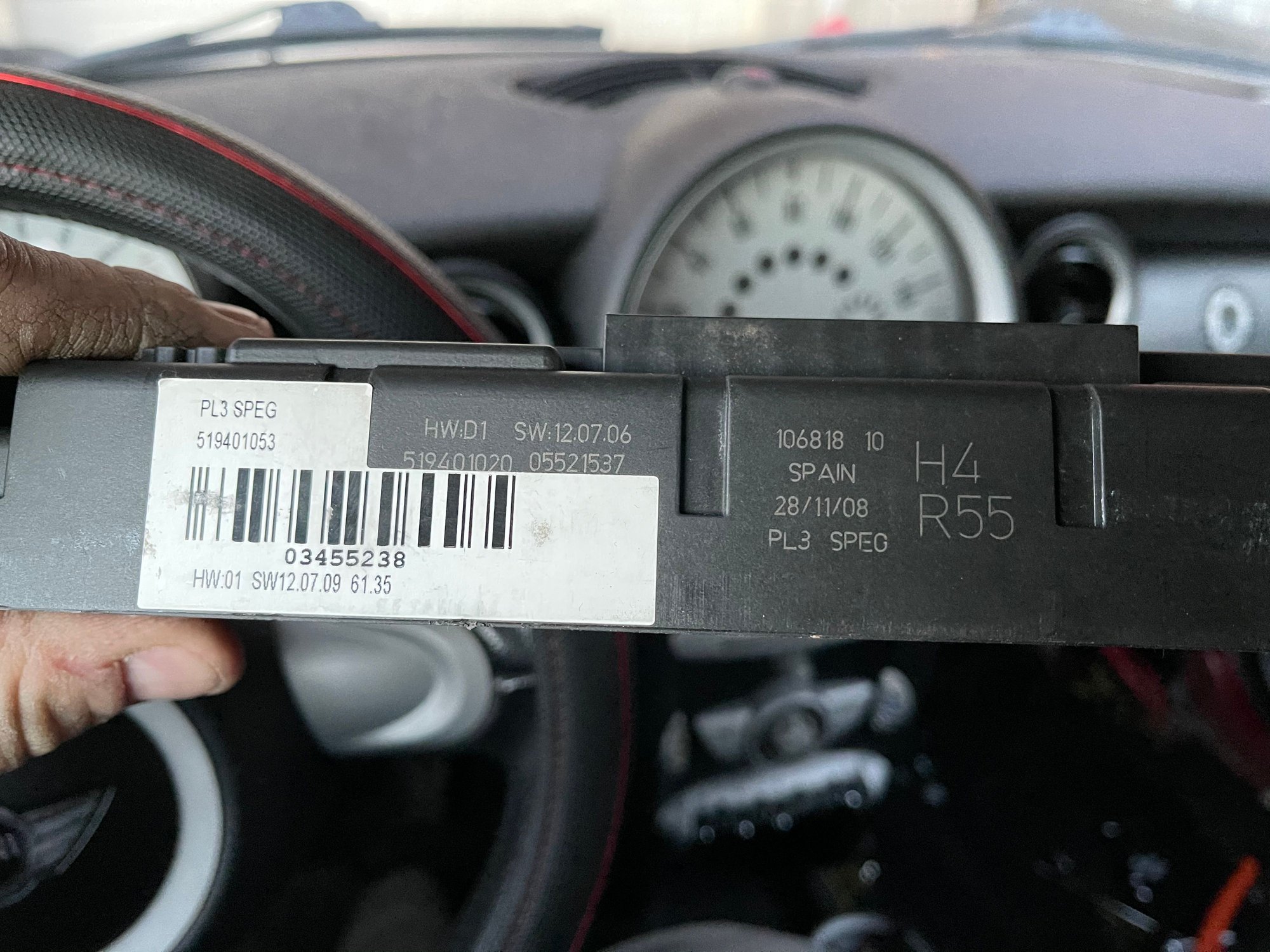

I am rebuilding a 2009 r55. The lower connectors on the SPEG were unfortunately wet at some point and very corroded. I bought a replacement based off the model that realoem.com provided when using my vin number. Looks like it is incorrect as it doesn’t have all the pins, fuses that my damaged unit has. There are a lot of numbers on the side. Which ones are important to match? Thanks in advance!!

Might not help you much
519401020
https://www.google.com/search?source...4dUDCAk&uact=5
519401053
https://www.google.com/search?ei=OVw...4dUDCA0&uact=5
Probably the HW 01 & SW 12.07.09 is also important.
