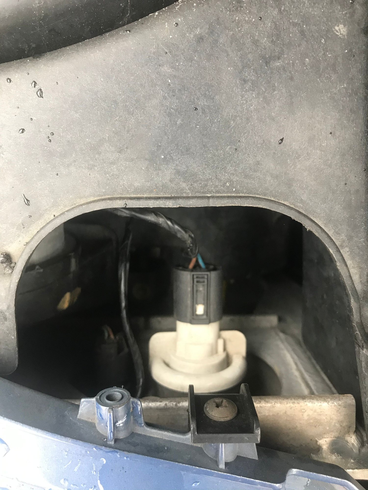

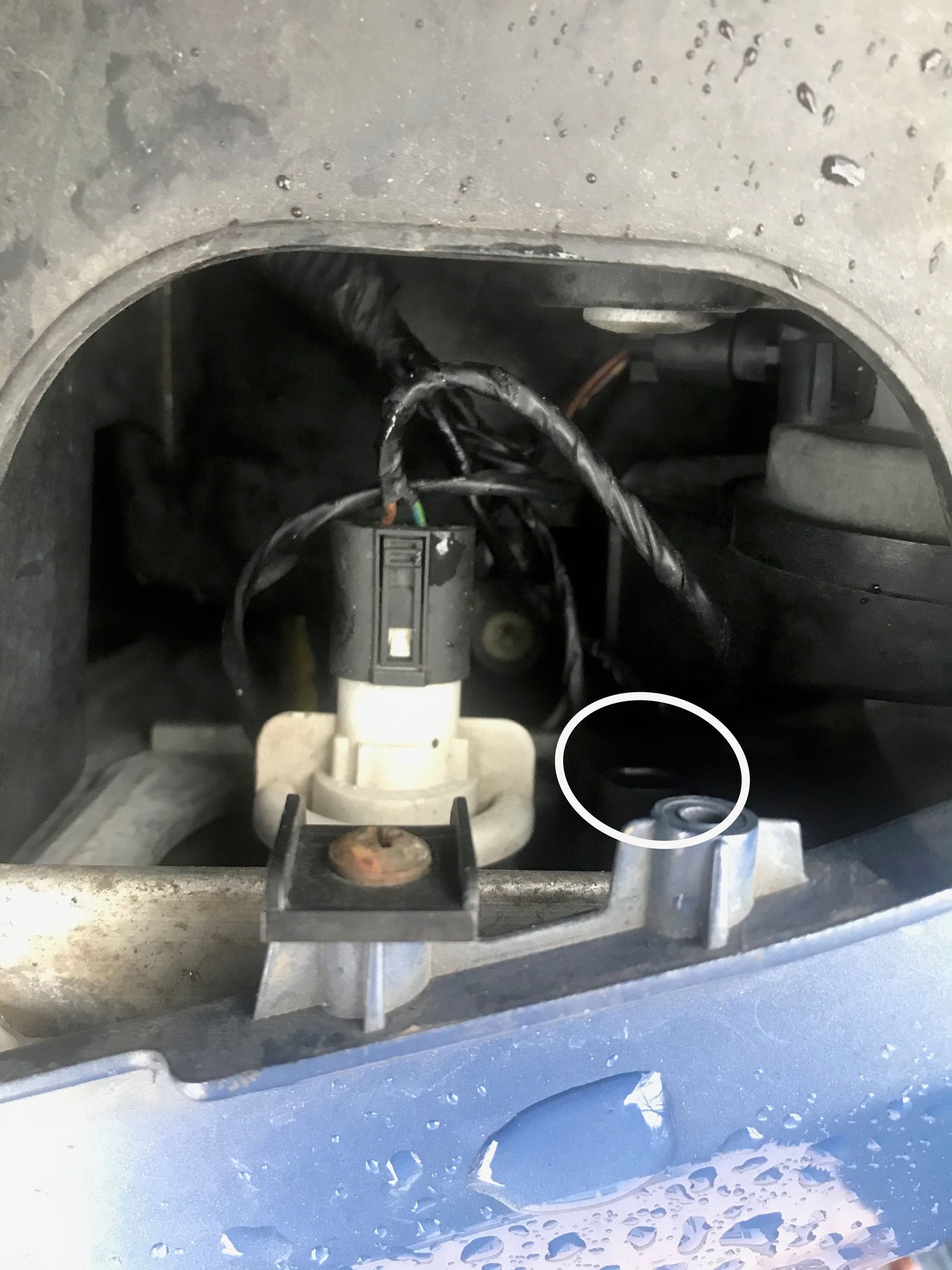

Thanks for the input. I just popped the hood, and I couldn't see anything wrong, but I'm not 100% sure what I'm looking for. It did look like there was a missing connection on one side, but I'm almost positive that it was for the light. I'm assuming the horn is below the light? Here are some pics:
Left side, looks like everything's connected
Right side, seems to be missing a connection?

For 2nd gen replacing horns was common.....not so for 1st gen. Mine are original......If memory serves the horns in 1st Gen are in series from pass side to dr side....if one side not connected I believe the other side will not work as well. Been a while since I've ever messed with them......
The socket circled is where the T10 bulb / socket for from marker ( parking ) light.....looks like they forgot to plug that in....

Looks like both horns are plugged in. As soon as I get a chance I’ll go and mess around with a multimeter. These are 12v, right?
