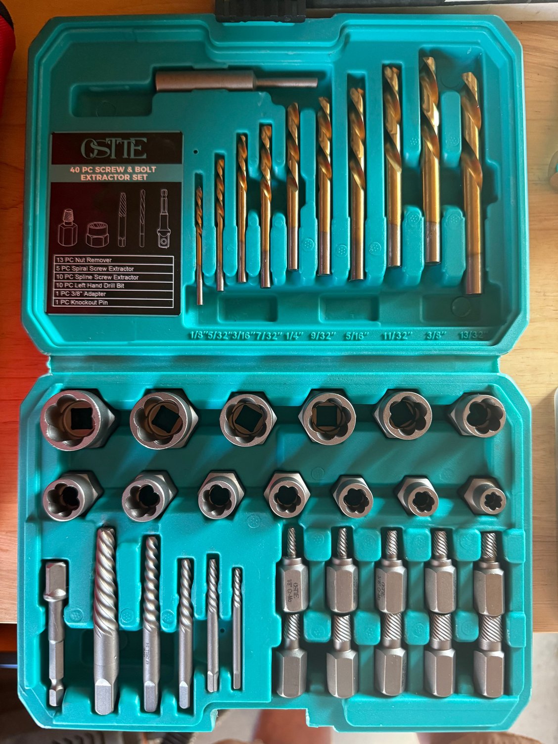

I got really mad at it and got my buddy to come over with his bolt extractor haha!

Either that or go one size up, hammer it in and give it a try. The bolt extractors work well too. I usually drill a small hole first to make is a snug fit.

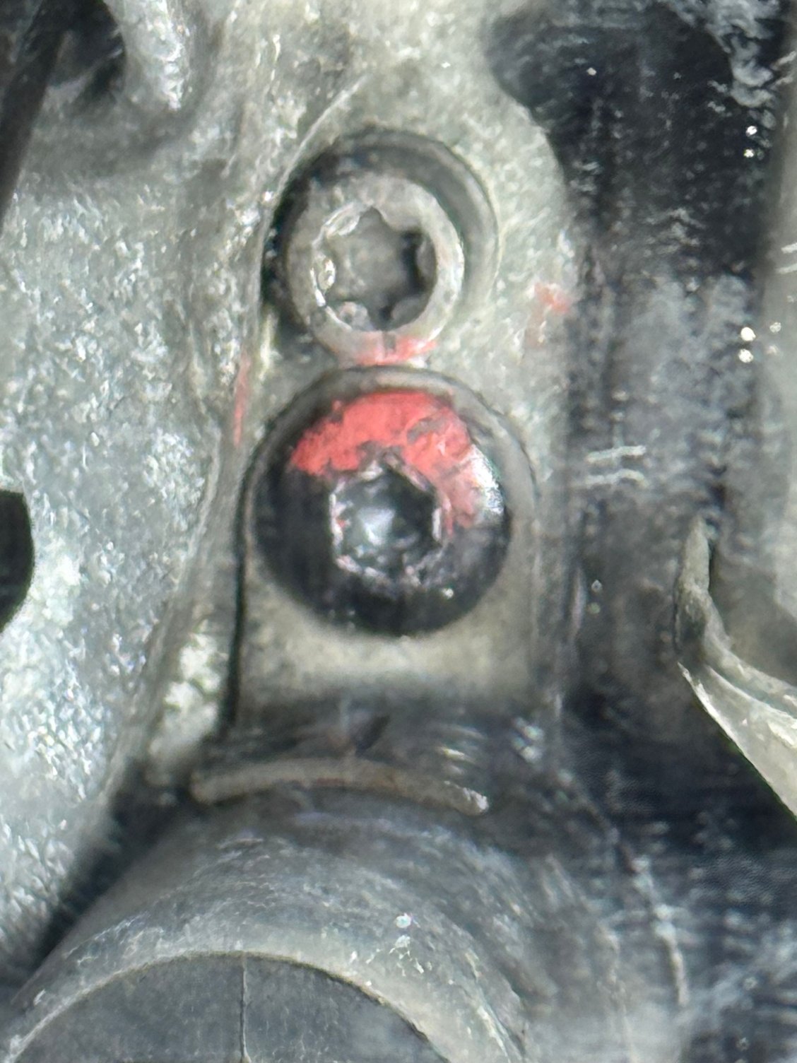

I'm on the struggle bus here trying to remove the front (exhaust) Solenoid... the T-30 didn't fit so (foolishly) I tried the T-27 which did seem to fit but almost immediately stripped-out. @Toby B mentioned needle-nosed Vise Grips but I'm not seeing how to get those into place. it's a 2013 Countryman JCW if that matters. :(

Looks like an Allen bolt, not a torx…. That might be why the head stripped out.

Wouldn't stripping a T30 bolt by incorrectly using a T27 bit result in a hex-looking pattern?
Gently hammering a T30 bit into the stripped bolt head could potentially be just enough to release the stuck bolt. The correct torque for the bolt is only 7-ft/lbs.
Once you remove the stripped bolt, replace it with a 10-mm hex bolt.

problem solved. thanks, @njaremka and @Maybe, maybe not.
