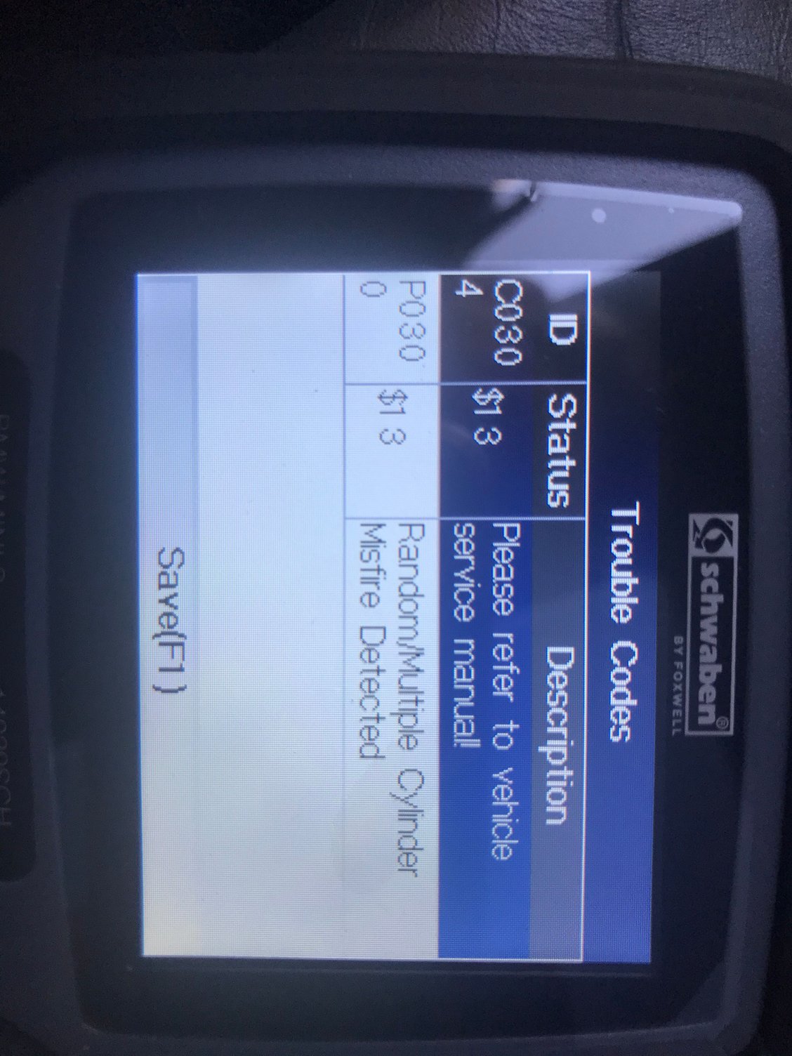

Well the coil pack came in today. I installed it an no change. Disconnecting bank 2 & 3 I get a weak spark out of it to ground and a strong spark from bank 1/4. It is obviously misfiring cylinders 2 and 3, but wonder what the $13 status means.

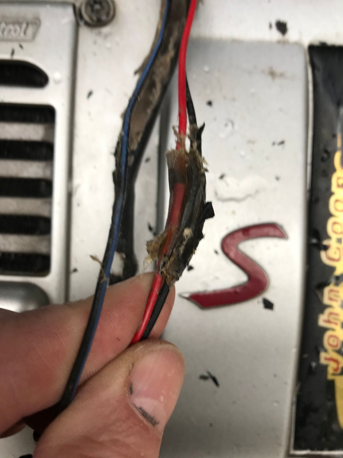

Well here I am back to finish off the thread. I found this thread here: https://www.northamericanmotoring.co...tor-issue.html and thought it would be a good idea to trace the wires back from the connector. First thing I noticed was electrical tape around the plastic pipe housing the wires. Hmmm a prior repair perhaps? I removed all the sheathing and found this clumped mess, so cut the wires and reconnected them (soldered), put it back together and runs perfect...but with codes I can't clear. For which I'll start another thread if I can't find any info on them. Codes C0700, C0304, P0300.
Thanks everyone for your help!
Mike
