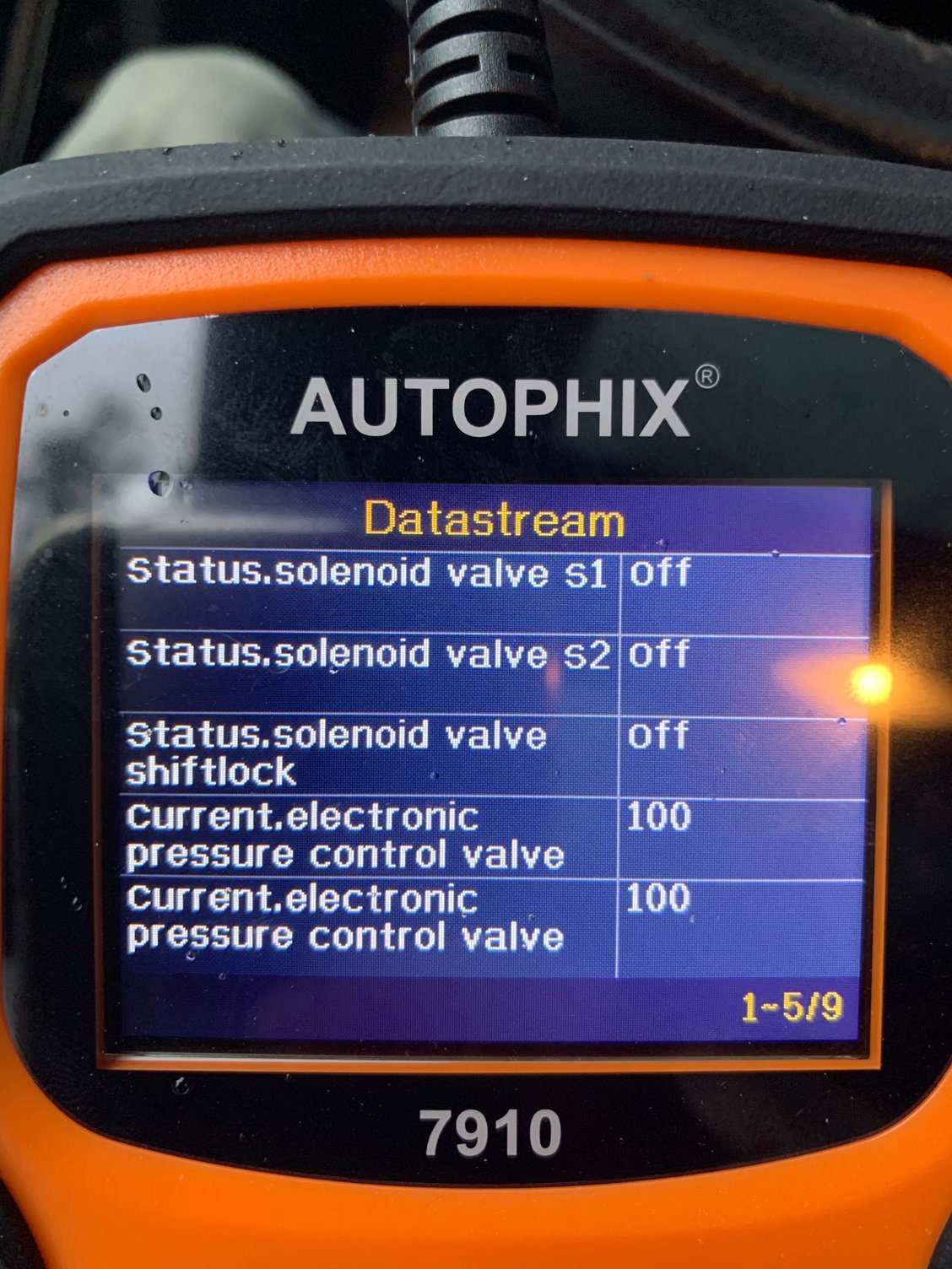

HELP!!! 07 Cooper S: replaced my auto trans & it was shifting smooth then a couple of days later it won’t shift at all! No matter which gear I put it in it acts like it’s in neutral. I plugged my scanner in my solenoids are reading s1 & s2 “off”, all of my electronic pressure control valves are reading between 980-1000 except for the last one is only reading 200

Old May 26, 2020 | 05:04 PM
John Mark Smith's Avatar
John Mark Smith
Joined: May 2020
Posts: 6

Posts: 378
Likes: 89
Well, I can't help you with that, I'm not familiar with what the parameters should be. I would guess if something is wrong with the valve body then it's possible the fluid level could be messed up, but I'm no expert on the Aisin transmission, I just have some experience changing the fluid on it.
You said you replaced the transmission: was this a rebuilt unit? Did it come with any warranty? How did you set the initial fill level, or did it come pre-filled?
