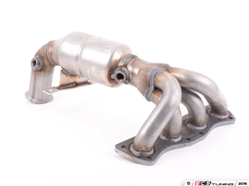

Haha okay now I'm confused, is the upstream the one that's near the manifold? It's at the front, basically by the grill?
Old Mar 13, 2020 | 08:46 AM
Posts: 36,767
Likes: 2,553
Top One. The one closest to the upper portion of the grille. It would be on the right hand side hole on this picture of the manifold.
