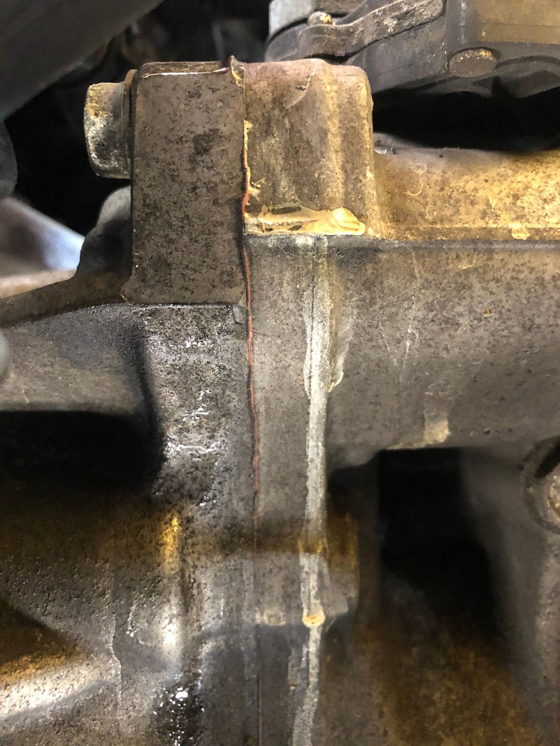

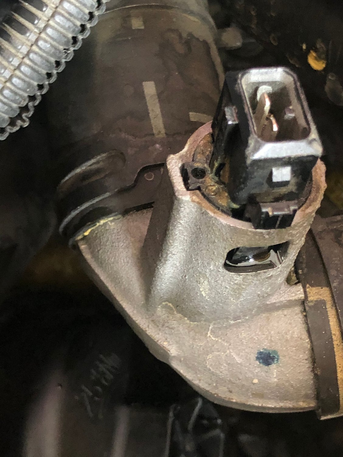

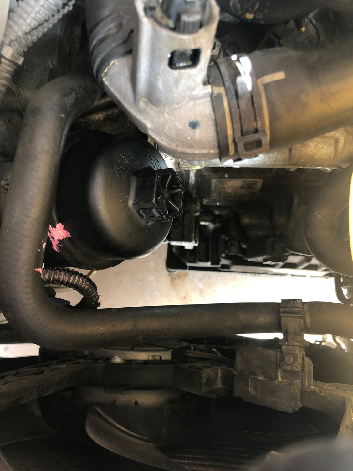

pics of the leaking spot and the residue where it’s leaked
Leaking from underneath this area, backside of joint had a layer of fluid so not sure which hose is leaking
Temp sensor seems a bit corpses making me think this may also be leaking through the sensor
Upside down photo of the residue from when I was trying to trace the leak.

as you mentioned, it could be the coolant leaking. I have the same thing on my 2012 convertible. for this small run, I replaced the hose/elbow with one that runs from the thermostat to the radiator junction point.
depending on location, here is the diagram...see item 1, 3 or 7.
https://www.realoem.com/bmw/enUS/sho...diagId=17_0578

I took it to a mechanic and he replaced the upper radiator hose (and elbow) with a single hose like you describe, cost me ~$240 including filling my oil as it is perpetually low (oil have a long daily commute so sometimes I go through a quart a week...sometimes a quart a month).
