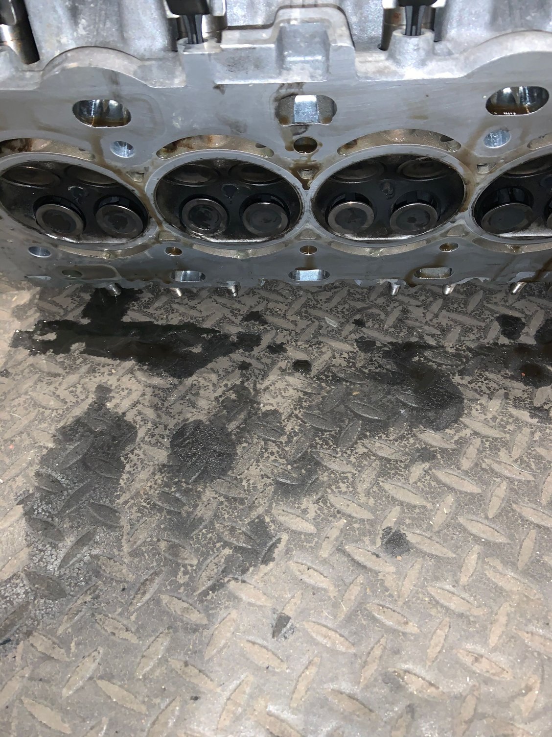

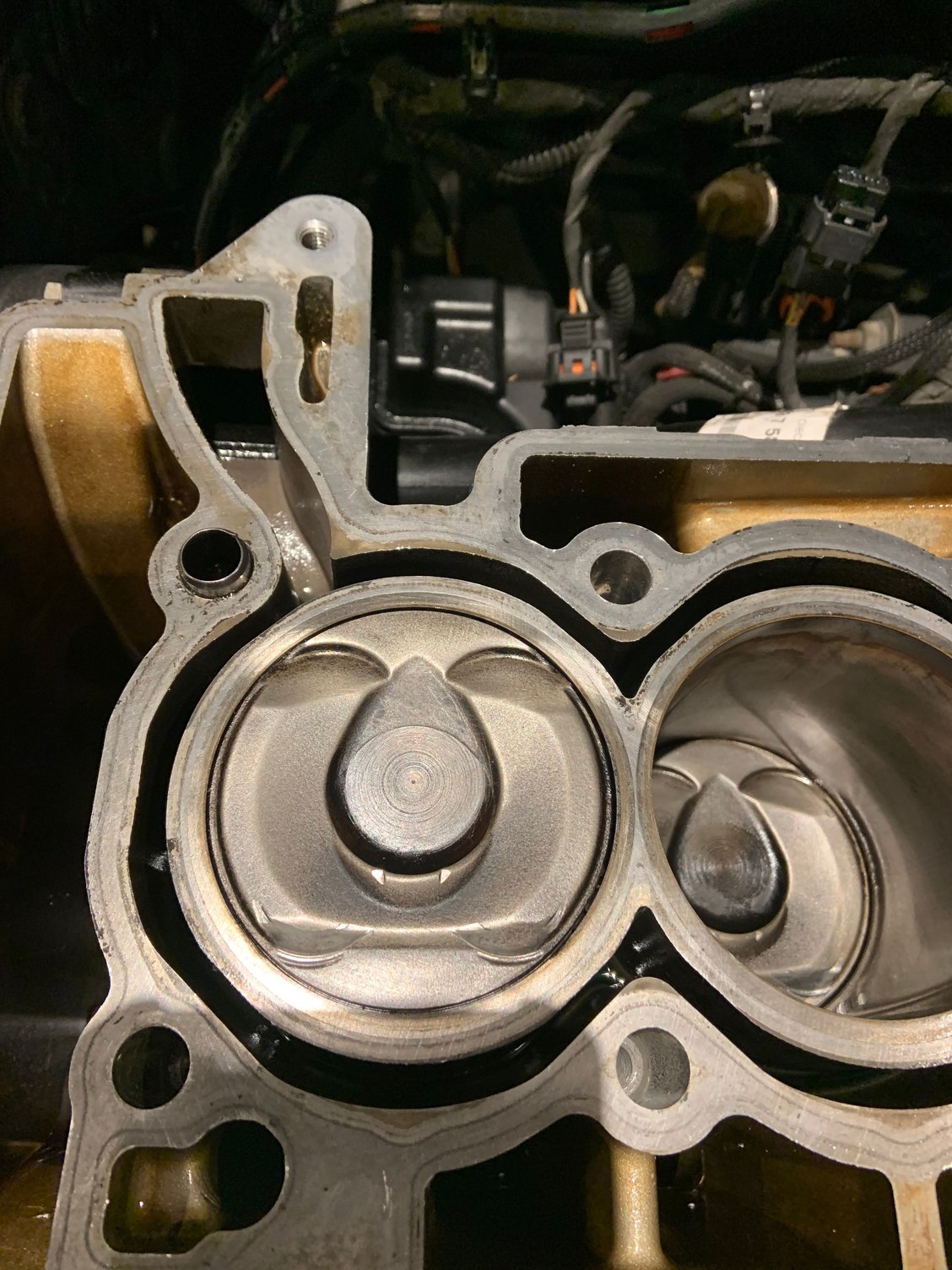

Well for a update I was told the noise was lifted noise and needed to rev the engine to 2500 or so to build oil pressure to pump up the lifters. So I did that and the noise started to go away then heard mechanical crashing noises. Took the valve cover off and the exhaust sprocket bolt broke and was laying in the chain cavity. Just got the head back off and every exhaust valve is bent and all four pistons have valve impressions. Obviously the valves need replacing but are the pistons ok like that
