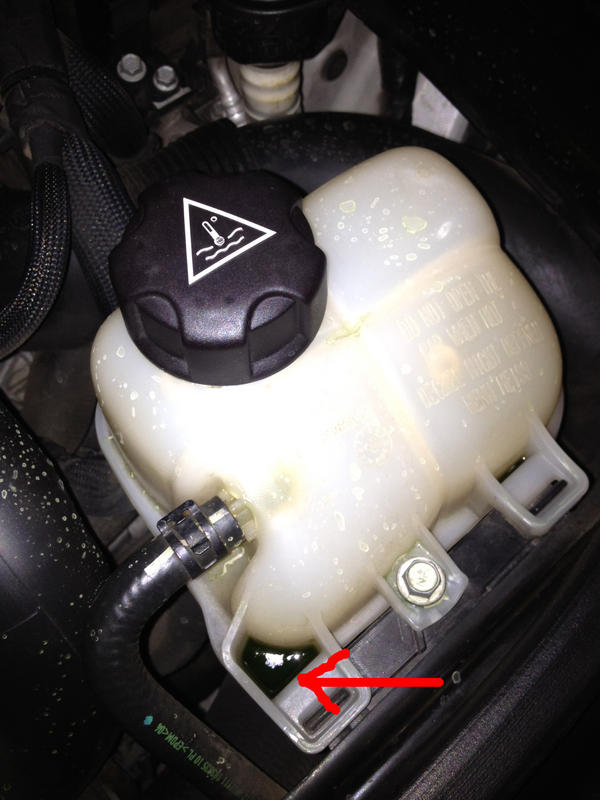

So, yesterday I was merging traffic on an inclined ramp. Pressed down about half way, suddenly the engine started to stumble, kind of like hiccups and suffocated. The engine didn't rev up, no power and feels like it's going to stall. (Similar issue to the one in the engine stumbling thread.)

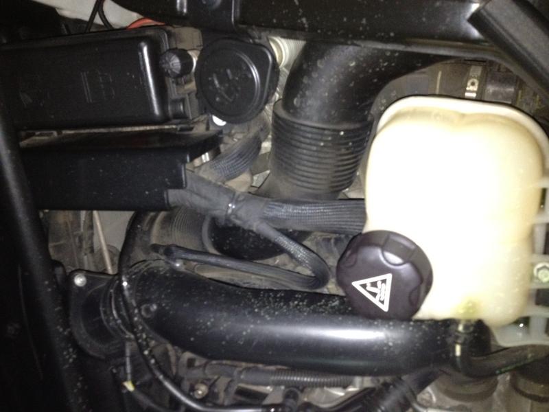

Got home, opened up the bonnet, saw the level of coolant lower than the min mark. Almost empty actually. Saw traces of the coolant all over the engine bay. Residues and water marks can be seen.(Photo) There's even coolant inside the pocket beside the coolant's reservoir. (Red Arrow in photo)
So, I topped it off, went to work the next morning and.... it happened again, came home, opened up the bonnet and the coolant level was empty...again.
Should I be worried? Since it's my only car and it will be pretty busy this week. Wouldn't be able to bring it in till next week. Where do you think the leak is? Did the coolant leak caused the stumbling and hiccups?! It's dangerous, especially accelerating on an incline!!
By the way it's a Feb 2011 Built Countryman S All4 with around 33,000 miles on it.
Thanks.

I could be wrong, but it's likely that the stumbling is unrelated to the low coolant.

Got home, opened up the bonnet, saw the level of coolant lower than the low mark. Almost empty actually. Saw traces of the coolant all over the engine bay. Residues and water marks can be seen too. There's even coolant inside the pocket beside the coolant's reservoir. (Red Arrow in photo)
You have an issue here. Coolant should not spit out all over the engine. maybe the coolant cap was loose and it spit it out was it reached a certain temp. But as you stated you filled again and it was gone again. Maybe you have a bad cap on the expansion tank. Check your oil for coolant to make sure you did not blow a head gasket. Hopefully your stumbling was not do to overheating. Take it to the dealer for a pressure check on the system. Are you in warranty still?

I thought the stumble was related to the coolant temp sensor recall - but I could be wrong. Have you had that done?
The temp sensor is in the back of the engine I believe so the coolant near the expansion tank would not be related. This is where a temp gauge would be nice to have...
I know you said you have a busy week, but I would make time to take it in.
