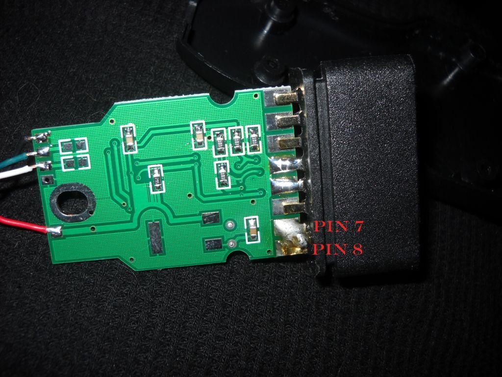

Check if have shortcut between pin 7 and 8 on INPA.If not, must do it.

Thank you for the reply, adriancl
can you expand on that. Pin 7 and 8 where?
Old Oct 14, 2019 | 09:24 PM
adriancl's Avatar
adriancl
Joined: Apr 2013
Posts: 334
Likes: 186
From: Romania
https://images.app.goo.gl/SAhuqcPaMj9ZuL7s9
Old Oct 15, 2019 | 09:55 AM
ssoliman's Avatar
ssoliman
Joined: Feb 2018
Posts: 1,755
Likes: 335
Gold sir, thank you
maybe I can find one already jumped for sale
i will report back

Is there a switch on the other side of your cable? Some of those cables have one built in to jump pins 7&8 when needed.
Old Oct 15, 2019 | 10:43 AM
adriancl's Avatar
adriancl
Joined: Apr 2013
Posts: 334
Likes: 186
From: Romania
Better with switch , because can do diagnosis also on CAN line for instruments culuster.
