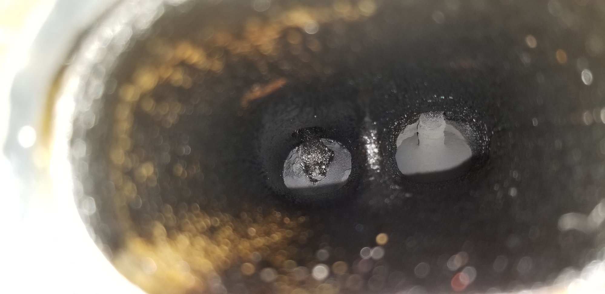

Here is carbon on the intake valves.
If the picture you posted is your valves they are pretty clean

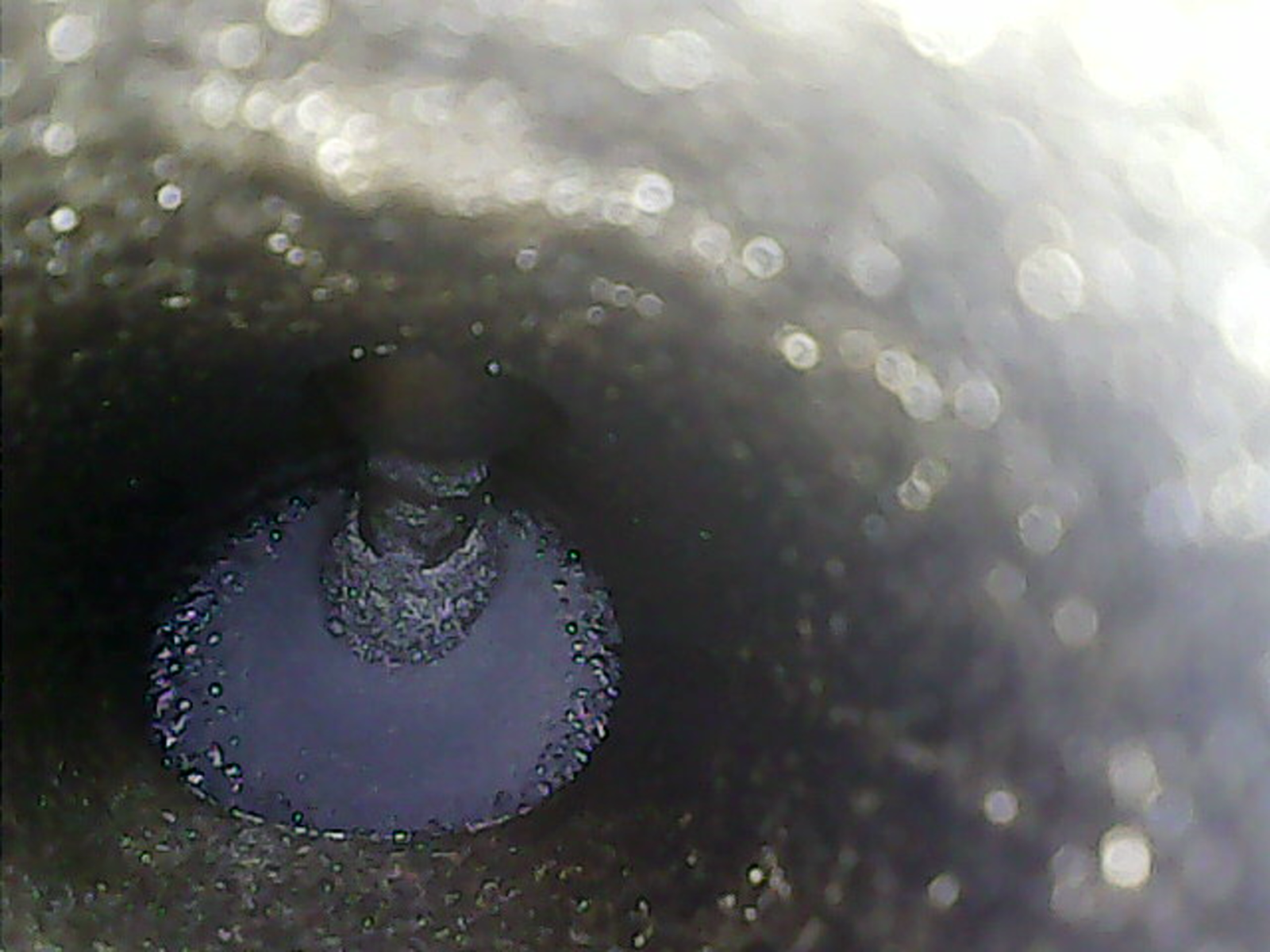

I removed my intake manifold to replace the coolant crossover pipe. While in there, I took some pics of my intake valves after 155K miles. This is also a N18 that just had CRC GDi intake cleaner applied a week before.
So it seems those off the shelf GDi cleaners do little to remove carbon buildup. Especially if you have high mileage.
