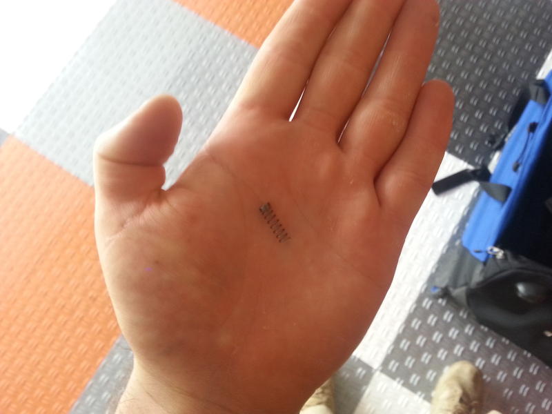

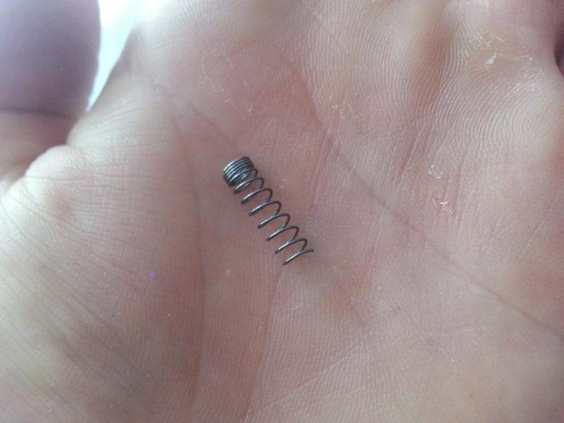

My wifes 03r50 drivers side window went out. While following the instructions earlier posted, I was pulling down on the motor housing after I unplugged it and took the 3 (not 4) mounting screws out.
When I pulled down on it a small (approx. 1/2 inch long) spring popped out from somewhere and I have no idea where it came from. Any insight would be appreciated.
It was probably a spring from one of the brushes.
HTH!
C ya,
Dutch
Old Jul 24, 2014 | 04:27 AM
  #55
patchelect's Avatar
patchelect
Joined: Oct 2013
Posts: 191
From: mars
And it looks like it was a hobbled replacement that someone previously had installed after losing the original. That spring is cut to length, a finished spring would have had both ends wound equally. That one will work however.
