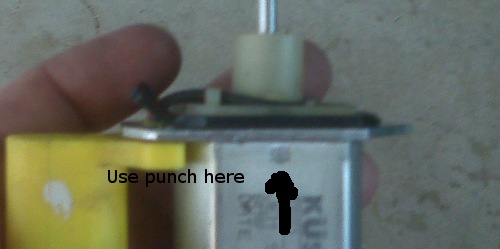

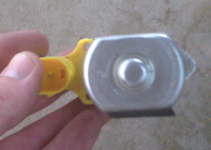

this was an excellent source to get my window fixed, however I can add a few pieces of advice. My car is an 06 and my window was stuck down. The motor is held in by 3-3mm allen screws and the clip is an impossible POS to get off, but there is a trick. I am also going to walk through cleaning the commutator and putting the motor back together.
So from my first picture you see the motor with the yellow connector to the side. to get your fingers on both sides of that clip while it is still attched is near impossible. I wedged a #2 Phillips screwdriver between the motor can and the clip to press the inner clip. Then use your fingers to get the outer clip, pull on the wire and there you go.. I got the clip off once with my fingers, not sure how though.
Next you notice the 3-3mm screws holding the motor in. When your window is stuck in the down position the easiest way to get these out is to move the window rails. Undo the 2-10 mm bolts on the bottom of the door and there are two more at the top, one behind the lock rod and the other behind the tweeter, both are covered by plastic caps. I also took the inner and outer weather stripping off of the top of the door to give me a little more wiggle room. Grab your window through the middle of the door lift up and slide it towards the outside of the door. Now the allen screws are a lot easier to reach. Reach up and grab the motor and pull down. Be firm the gears could be bound since it is stuck but it won't hurt it. Once the motor is out you can pull your window up to get even more room.
Now you have the motor out. you need to take apart the motor, first you have to remove the leads from the connector to the motor. There is not much extra wire so use your soldering iron to remove them. On the pic below I marked where to pry the plastic cap away from the can. No need to remove the worm gear you will have enough room to work. Clean the commutator with some emory cloth and electrical contact cleaner, then reassemble the motor. Using a punch and a hammer reattach the cap to the can at the marked areas. Resolder the leads back on then put everything back the way you found it...
