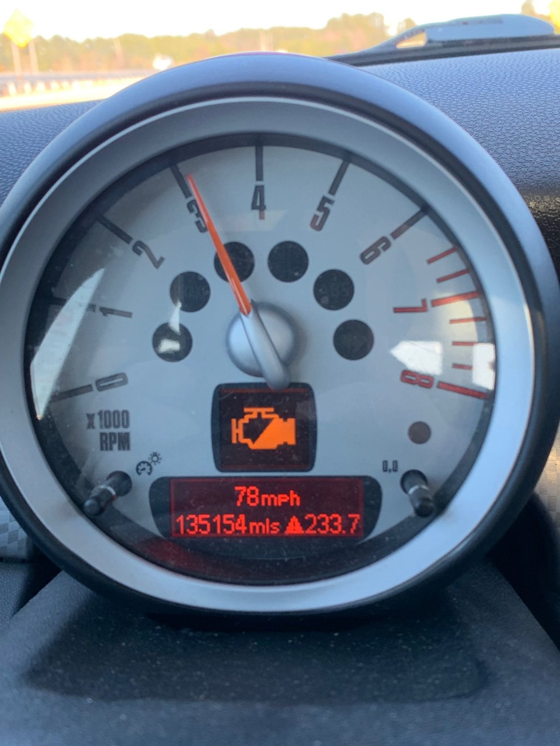

Evening Gents. I'm having an "issue" with my 2008 Clubman S and I'm getting nowhere with my local dealership. Just pretty darn fed up with them. Nuf said...
Here's the problem... I continuously get this light on my clubman...
I've been told everything from a vacuum pump problem to the turbocharger, or turbo waistgate going bad. Not sure "why" the waistgate was mentioned, because if that's what it is, it can't be replaced by itself. Either way it's a complete turbocharger replacement! The maddening thing is - the car seems to run - just fine! It's not stumbling, missing, etc. Sometimes the light will go out - on it's own and other times, I have to intervene - usually by removing the negative terminal on the battery while the car is still warm. And by the next time I drive it - at least 6 hours - the light's out. However - having the car in the wrong gear and giving it a little too much gas, seems to trigger the light to come back on! Doesn't always have to be with me giving it gas either! I can still press the car a little hard (no higher than 5K RPM's in any gear) and the car doesn't hiccup, sound funny, or act sick. There are 2 things that I have noticed though: 1) shortly after startup and driving a small distance, when I stop, I smell something that seems like it's burning. The first couple of times I smelled it, I stopped the car, got out and checked under the hood. The ONLY thing I could figure was some oil on the engine after having the timing chain and chain guide recently replaced. The engine block - under the vacuum pump - doesn't look like it's got oil on it, nor is there any oil pooled on top of the transmission, which are signs of a bad vacuum pump. 2) I also use to hear a little "whistle" between gear shifts and attributed it to the turbo spooling down a bit between shifts. I don't hear that anymore. Even with all this - the car runs fine?! At least as far as I can tell. But... for this stupid light to keep coming on SOMETHING'S wrong somewhere!
So - I thought I'd bring my issue here - hoping and praying someone smarter than myself could help shed some light on this! I'm going to an independent dealer in the morning to have this light read and find out what the exact code is.
If it "IS" the turbocharger going bad, I think I can replace it, but I'm honestly just not sure what to replace the existing turbocharger with?! I understand BorgWarner makes one of the best on the market and I'm hoping for something other than a Mini part. I've not been very pleased with the few parts I've had to replace that "required" a direct Mini replacement! And if I've gotta' replace the turbocharger, I thought I might go a bit larger to offer me a little excitement when I press on the gas!
So... ANY help you can offer, would most greatly be appreciated!

So, I had it checked again and this time - no codes were evident, even though the light was still on. I had the light cleared again. I've driven the car for the past 2 days on my daily commute (126 miles round trip) with the light staying out. I know these cars use oil so, I checked the oil level last evening and added a quart this morning before leaving for work. Drove to work - no problem. When I left to come home this afternoon, I once again, began smelling the oil burning smell that I mentioned in my 1st post! I notice a light amount of steady smoke coming from under the hood and coming out of the hood scoop. This seems to happen primarily when the correct amount of oil is present. The smoke seemed to be coming from under this area...
Within a short few minutes, the smoke seemed to stop, although I could occasionally still smell the oil burning smell. About a third of the way home, this stupid light came on again!! I drove straight over to my friends place to have the code checked. Here's what it read...
He stated that this indicated a possible pressure issue on the cold side of the turbo, although he didn't have information for the actual code: 2885. He also said he could smell the burning oil smell. Now I'm wondering if the smoke and smell could be coming from under the vacuum pump. I'm so confused now, I'm not even sure where to begin! I've had the light cleared - again - but there's no question it'll end up coming back on again.
Any ideas guys?! Is it the turbo going bad, or maybe another vacuum hose loose under the breather box. I have NO clue. ANY HELP greatly appreciated!!!!!
