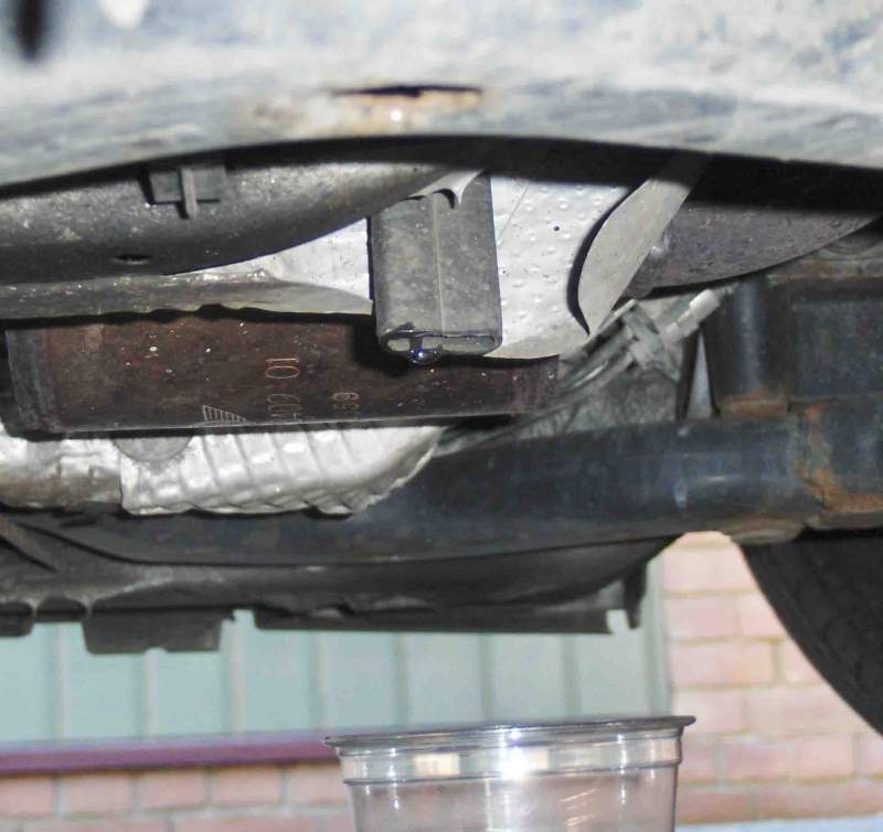

Thanks guys, I didn't realize there was a cabin filter; I'll check it for rodent signs as soon as the ice from the last storm melts off the cover so I don't crunch it. I found a photo of the evaporator drain underneath the Mini in the archives.
I can't remember now if it dripped when it was warm enough to run the AC, but I never had any drips in the cabin. Do I poke a piece of weed trimmer line up to see if it might be plugged? or try to rig a shop vacuum to suck it out?

Might need something stiffer than weed trimmer line. Use a stiff piece of wire. Problem is trying to flush it out without and condensation. You could get a small syringe and a length of plastic tubing that you can slide up in there and inject some water to flush out any debris. The vacuum idea might work also. You can change the cabin air filter easily. Filters aren’t cheap though if you get it in the parts store.

Don't use compressed air, that can cause the connections in the drain to come apart.

Is there anything above the drain that could be damaged by poking a wire up there? I'd hate to cause a core leak.
And I agree on no compressed air; over on the Land Rover site one fellow tried using compressed air to clear his slow gas filler vent tube and blew up the charcoal canister in the engine bay.

Just go easy with the wire. A large gauge auto electrical wire would work like a 10’or 12 gauge.
