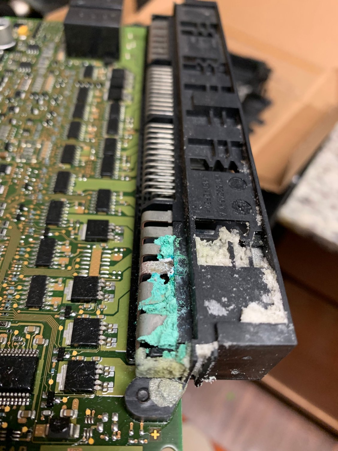

Resolution
So I had a friend (who is an ex BMW/MINI mechanic) scan my car for me and he determined the issues were due to a failed footwell module. Lucky for me I had the ability to scan my car before I took it to the mini dealer so I knew better than to spend $900 on an unnecessary new headlight assembly (I have the self leveling bi-xenon lights)...but $1,560 and 2 weeks later I got my car back and the following photos are what my old footwell module looked like.
The outside pins show some corrosion...
But after I opened it up it’s no wonder my lights failed.
