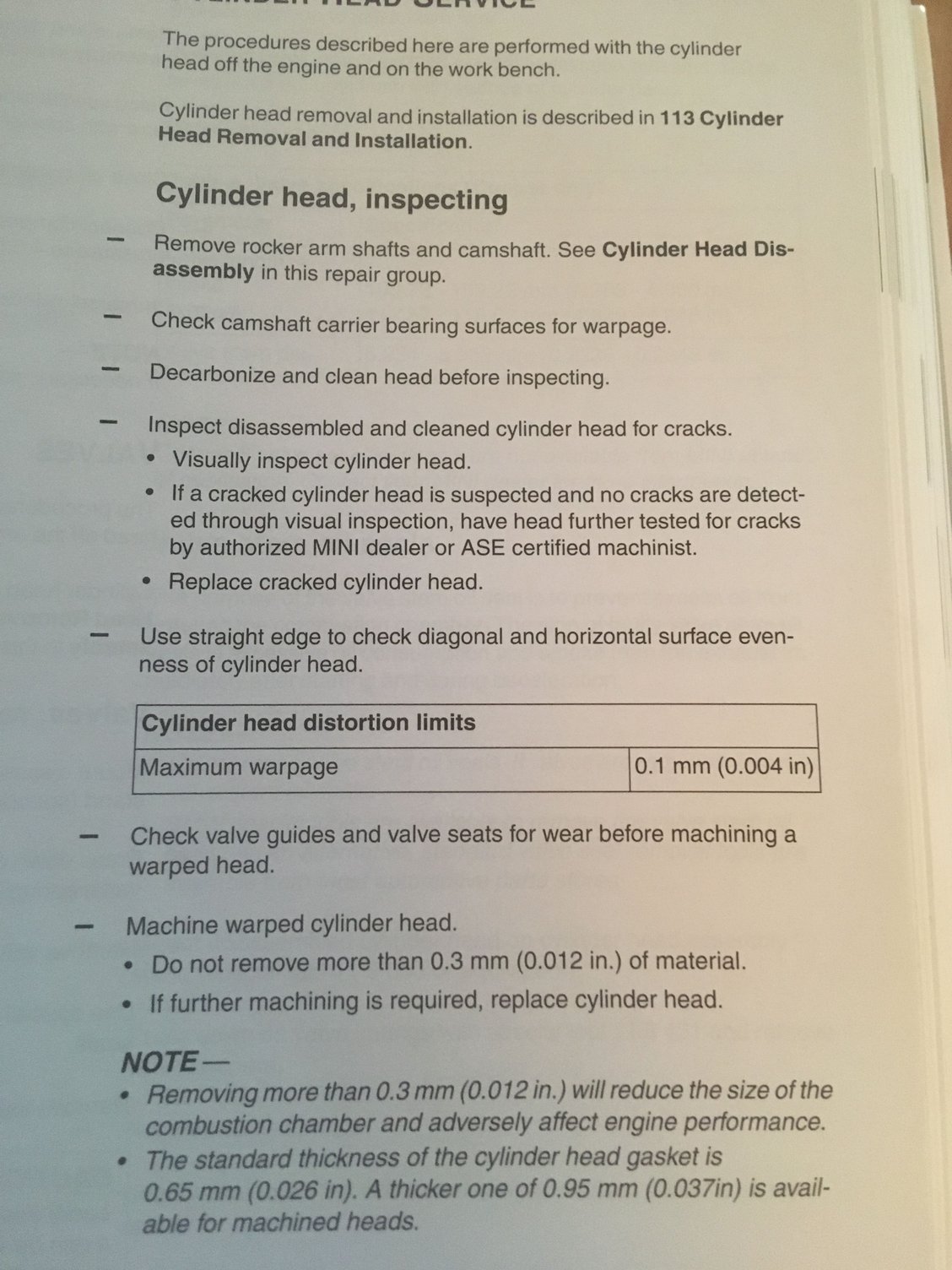

Is this what you’re looking for? Photo because I’m lazy.
thanks for the reply. That works if you have a head that's never been rebuilt. Unfortunately, mine appears to have been reworked before. So what I really need is either the initial deck height or the minimum.
