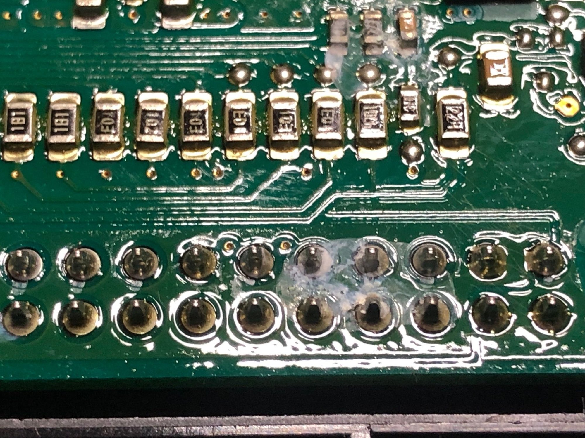

I wouldn't worry about the codes yet, they could be a symptom rather than the root cause. I'd start by disconnecting the negative lead of the battery and removing the footwell module, aka the FRM. Take it out, and keep tearing it down until you have a printed circuit board in your hands. Be careful with it. Take it inside, keep it clean, and work on a soft surface.
Does it look like it's ever been wet? Is it corroded at all? Is every pin clean and straight? Is there anything connecting adjacent pins or solder points? Look closely under the plastic electrical connector ports. If it looks virgin that MIGHT not be the problem, but most of your gremlins (and maybe all, but I don't know about all of them) are managed from that device, and they're prone to water damage.
It's not hard to pull it out. If it fails any of the tests above, it's a manageable fix that might only cost a few hundred bucks. Or you could get super lucky and clean it up well enough to go back in with a solution to your problems. Or it could just be a wasted but fun saturday adventure.
Here's a useful thread. ANd here are some nasty-*** pics of mine. I get multiple K-CAN errors
ewww
